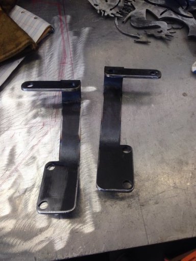

IMG_0216.JPG Got the new and improved brackets installed today. Now I need to fill that extra hole with a CB antenna.

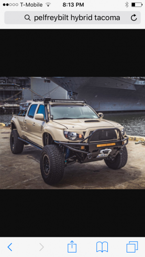

Here's what I'm looking at. IMG_0324.PNG Sos off-road heard nothing but good. Like how tall the guards are. IMG_0323.PNGLove the classic look of ARB, plus I can have one in just a few days instead of weeks. IMG_0322.PNGLooks good. IMG_0326.PNGPelfreybilt best looking hybrid bumper currently.
