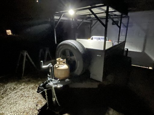

Spare tire mounted. Had to order a 12" stick of 1/2"-20 threaded rod on Amazon. No one local carries 1/2" - 20 rod around here. 1/2" - 20 allowed me to use a matching lug nut to hold the wheel on.
Also figured out the the propane tank fits perfectly in the triangle left in-between the spare tire and the jack. Now to run some hard piping to get gas to the back of the trailer for the cooking stove and to hook my buddy heater to.

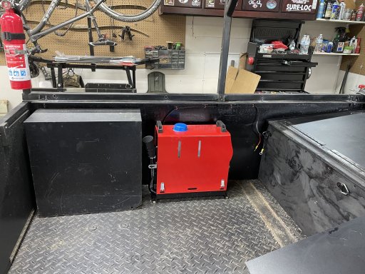

Picked up a diesel heater last week and mounted it. Ran the exhaust through the trailer floor. My little buddy heater worked pretty well but this should eliminate any condensation or deadly toxic fume worries. :) Will be simple to duct the hot air right into our annex through the zippered door that is on the side of the annex toward the trailer.

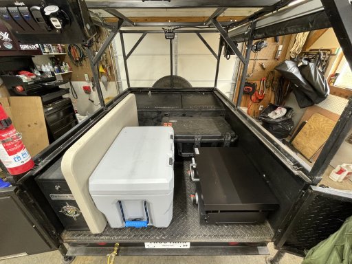

Did a test fit with all my main stuff. I hinted around for a Blackstone griddle for Christmas. My wife picked up the 22" instead of the 17" (got a heck of a deal on the 22"). I was worried that it all wouldn't fit but it did.
My table is an issue now that I have the tarp. Gonna have to find a table with a folded dimension of 20" or less. May end up going with a fold out frame/roll top table.
The black plastic SKB case in front of the grill is my kitchen box.

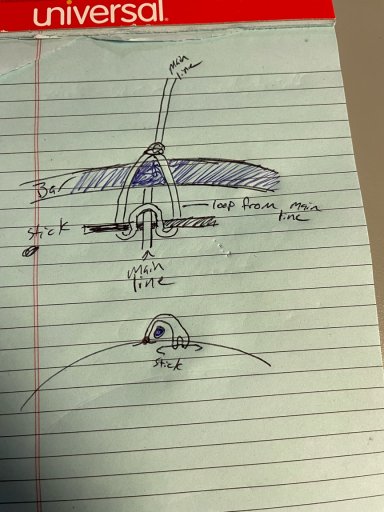

Only the outside ones, the internal ones have 5 Velcro loops that hold the tent to the canvas. You could get around this by just using a round rope ratchet strap with a loop tied in wherever needed. I’ve rigged awnings by folding the loop over a pole/pipe/branch and around each side of the main line. Slide a stick through the ears and it’ll prevent the loop from coming undone. For a more secure method, make the loop large enough to wrap around the bar on each side of the main line before putting the stick through.

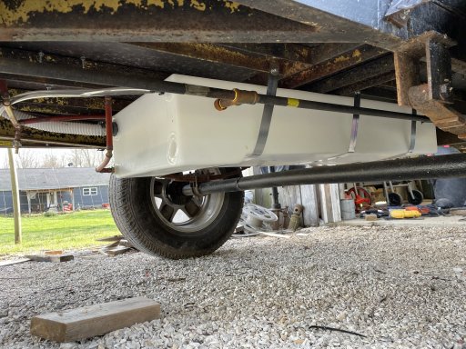

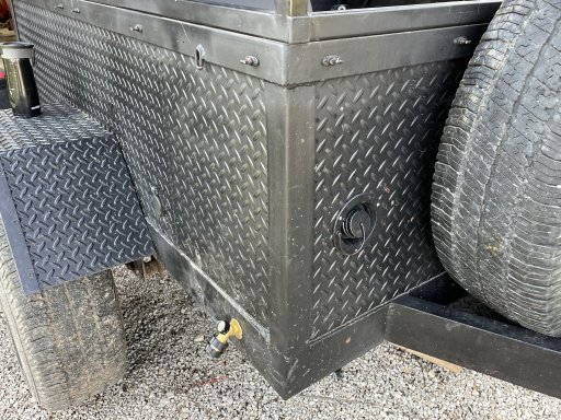

Installed a 35 gallon water tank and plumbed in a fill port and a couple of spigots. I have it run through a 12v RV water pump. We bought an on-demand water heater/shower as well and are waiting on a pelican type case to mount it permanently somewhere on the trailer. I'll get some better pictures of everything this weekend.
Fabricated a mount for a diesel container.
