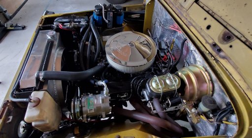

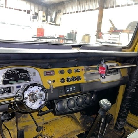

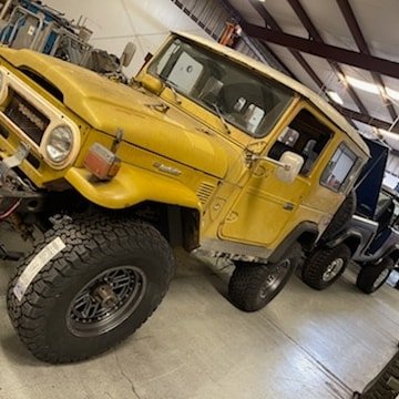

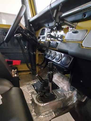

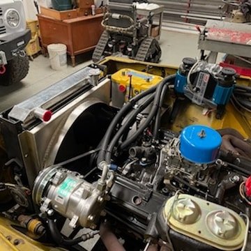

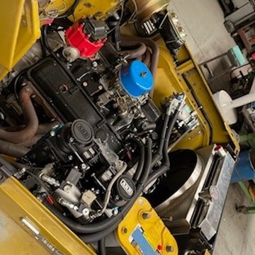

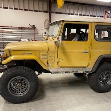

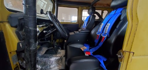

After almost a year, phase 1 update and refresh of my 1978 FJ40 is nearing completion. The supply chain for parts have been incredibly delayed. The V8, 5 speed, 4:1 Orion Transfer case, 4-wheel disc brakes, 29 gallon under seat and 24 gallon rear axillary tank installed. I added a/c and new bucket seats, air lockers front and rear, dual air, dual battery and RedArc controller.
Getting close.

Love the color. This rig, never to be sold!
cheers mate!
