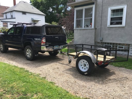

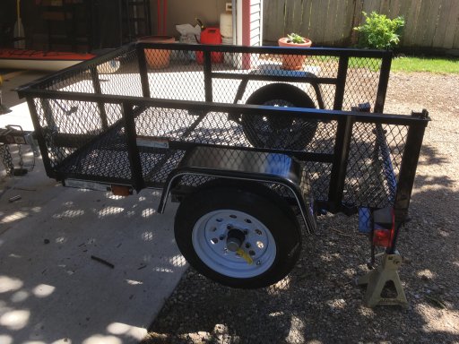

So I bought the lowes ((carry all) trailer ,
Flipped the axle and installed a jack
Does anyone have a source for wheels with more offset? ( need them to stick out away from the frame)
I want to put 15” rims and tires on before I install the rtt and modify the ladder
I’ll update pics tonight
You could go with spacers, or find a wheel with the offset you desire. I went with a new axle on mine, but I wanted six lug hubs as well so it worked out for me.

63F66897-6F9E-4F95-B0B2-2149CCDECBE8.jpeg DBA456F6-47D1-46A9-A3C9-A32E7BF30161.jpeg 63F66897-6F9E-4F95-B0B2-2149CCDECBE8.jpeg

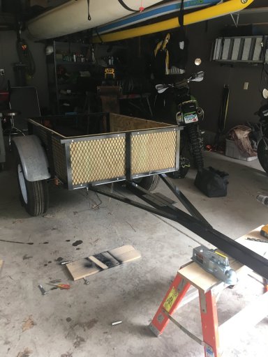

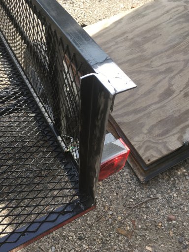

Got the fenders removed and cut the channel at the rear, I’m going to use the slide in tailgate to fabricate a swinging gate hinged on the drivers side
I looked at some wheels today at Tractor Supply and they have some narrow 15” rims that look like they will fit but Fleet Farm has some on sale for $40 less each so I’m going to look at them tomorrow
I’m going to get properly sized fenders and box it out with treated plywood then make a rtt rack with the uni strut that I already have
Someday I may extend the tongue and get a swiveling hitch but I’m trying to get it operational by 7-27

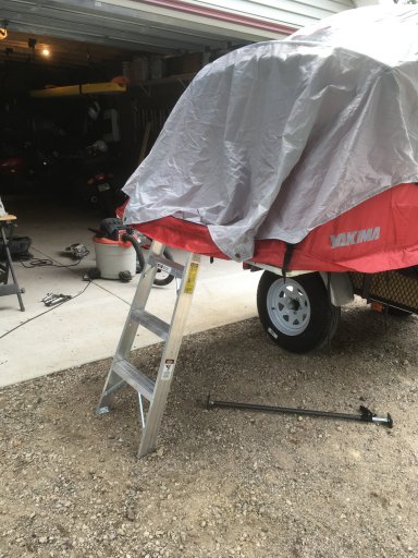

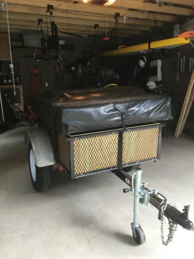

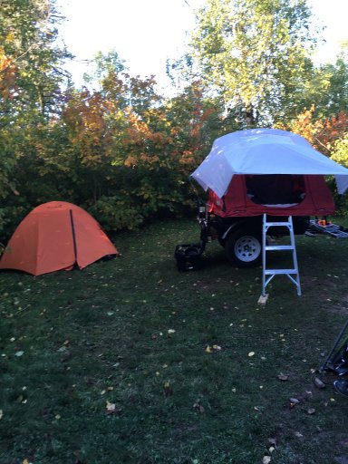

1E5D4FB3-AE30-4640-A89C-2F546F8B2B2E.jpeg F6B8B4D5-4BC8-423B-B7CD-5F70CBD3B9E6.jpeg 192C963C-346B-4801-9FA1-65893452F472.jpeg Making good progress
The pics aren’t in order but here’s what I did
Axle flip,converted to swing open tailgate,15” wheels,new fenders,and plywood inside.
I’m not sure how I’m going to fasten the plywood yet maybe pocket screws and bolts through the frame
We are going camping next weekend so I’m trying to get it ready by Friday
I’m going to install the RTT the same way I had it on the other trailer with simple uninstrut cross bars
That will replace the structural integrity of the rear that I lost by converting the tail gate.

Got the RTT mounted yesterday and the plywood secured (mostly) should be good enough for this weekend.
I’m going to modify the step ladder and try to come up with a mount for my 20lb propane tank tomorrow
Will get pics tomorrow

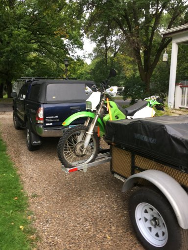

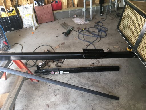

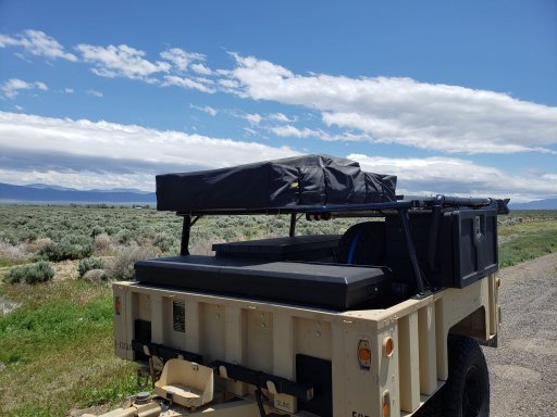

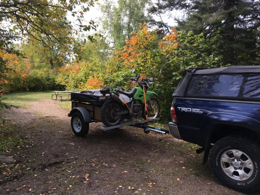

Got the extended tongue done and Moto hauler mounted
Seems very solid,less wobble than when mounted in the receiver hitch , and it worked perfectly that way
I made it a simple bolt on affair so I can easily reconfigure back to hitch mount
View attachment 110792View attachment 110793
very cool. at first I thought a lightweight landscape trailer ???
Then I saw the plywood box, looks so cool contrasted on the expanded metal.
And a REAL ladder fitted. Another very cool piece.
Following this build, Great ideas.

Voice of experience not loud yelling or critizing but the tongue you may find to be just a bit too long you don’t want to exceed 1/2 the trailer length or 3/4 of the width, reason being when you start towing yes it toes very nicely but off road it will go squirrel on you it will hang up on overlaps rocks that don’t move and when you drop off it may or may not hang you out and come back around on you give it a try and let me know what happens good looking rig though have fun
Dcwn.45
1,338
Minnesota
David
Nyman
30299
KF0GNE
Thanks Rubiconcruiser for the thoughts, I really don't go on much more than forest service roads in Mn and Wi. No Rubicon around here! I tried to err on the side of too long, I can always shorten it if needed. After I do some testing, I may be able to shorten it by a foot, The coupler is a bolt on for that reason.
I don't plan on using the Moto hauler on anything too rough, it's easy to unbolt.
I appreciate the feedback, it's just trial and error at this point.
