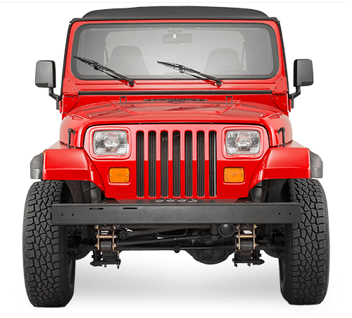

The small bumper is what's on it now. (*the pictures are in chronological order) It's actually a stock bumper that's been cut down and welded back together. The bumper was cut so it's just wide enough to protect the Aux. lights I run. Then some of the spare metal was welded back onto the ends to cap them off. The OEM bumper gives you the best approach angle as it does not add much to the end of the frame. The reason for cutting the number down was that when you run into something with the stock bumper, it usually bends at the end of the frame and wedges itself into the tire.
The two holes are usually horizontal on a YJ bumper but we reused them then welded nuts to the back incase I ever want to bolt something to them. It was a why not spontaneous thing.
OEM Stock Bumper:
Here's an older picture of the Jeep but you can see the bumper without the license plate getting in the way. (*old picture when the Jeep was on 35x12.5R15's)
