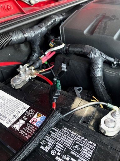

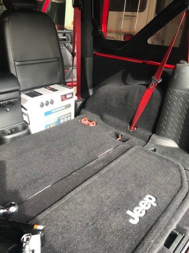

I know you said you didn't want a permanent solution, however, you are wanting to power a fridge. If you are constantly driving, or you don't care about stability it temperature at night when it would drain your battery when not moving, then 12v or works. I did a lithium battery with an amstrong plug attached to the battery to charge which would run the fridge for 4 days without additional charging. I also had an solar panel with an Armstrong plug to charge when camping. My fridge was a SnoMaster which is awesome. The lithium battery and housing box can be moved to another vehicle very easily. The nice thing is that it powers everything and charges all your gear that needs a charge. Wanted to share an alternative for using on board 12v.
Nice setup! That is one serious battery and fridge for sure!
