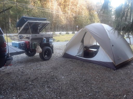

I tried out my Mr. Buddy heater for the first time this weekend on a camping trip. Love it!
I put it on a baking sheet inside an 8x10' tent with a cot. Like others would do, I would turn it on while getting ready for bed, then turn it off as I was slipping into my sleeping bag. In the morning I'd turn it on while changing my clothes, and then turn it off when leaving the tent. It warmed up the tent fast!
I had a ton of ventilation in the tent, so that was never an issue.
The morning I left it was cold and snowing - so glad I had it as I was getting dressed and getting ready to break camp.OB Feb.1.jpgOB Feb.10.jpg
