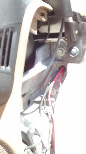

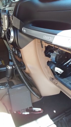

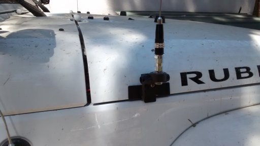

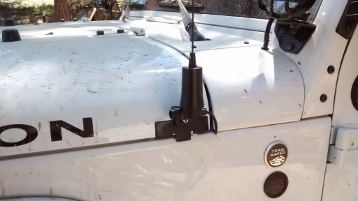

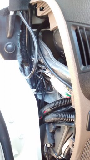

The install has taken WAY more time than I thought, but more due to acquiring parts. Apparently the Idaho mtns are two weeks from anywhere and the comm shop an hour away closed down for a three week vacation.
But I finally have the antennas, mounts and Cobra 75 installed and the Yaesu 8900 hooked up. I am waiting for a longer cable to remote mount the faceplate.
After mounting the hardware, I ran an extra antenna cable roughly where I wanted to install it in the Jeep to test SWR's, but am using new antenna cables for the install as I fished them through the 3/4" holes running on sides of the dash and installing the connectors after fishing; CB on the passenger, and the 2/70 on the drivers side. My boyfriend apparently has done this many times, I have no clue.
The 2/70 cable is then routed up through the visor area and down the passenger side then through the dash. I opted for this route as I have a ton of lights and electronics running all around the dash, and figured I'd have less interference. So far I'm getting an SWR of 1:1 on the 2/70 and 1:2 on the CB and not noticing interference, hopefully that will stay the same when I test the installed cables.
I'm not sure if I got the wrong part or missed an adapter, but I had to modify my Diamond mount to accept the Larsen cable and mount the antenna by filing the mount a bit. Still looks good, but I haven't read of anyone else having to do this.

IMG_20170711_112638566.jpg IMG_20170711_112556698.jpg IMG_20170711_112745861.jpg IMG_20170711_112708404.jpg IMG_20170711_112723960.jpg IMG_20170711_112638566.jpg 2/70 install (driver's side up and over to dash.
IMG_20170711_112638566.jpg IMG_20170711_112556698.jpg Cable through firewall and up around windshield IMG_20170711_112745861.jpg CB control box mounted in dash under glove compartment. Yaesu 8900 temporarily mounted on side of console. It will be permanently mounted under passengers seat with remote faceplate in front of shifter.IMG_20170711_112708404.jpg CB antenna on passengers side IMG_20170711_112723960.jpg Passengers side CB cable through firewall and both antenna cables fed through dash.
