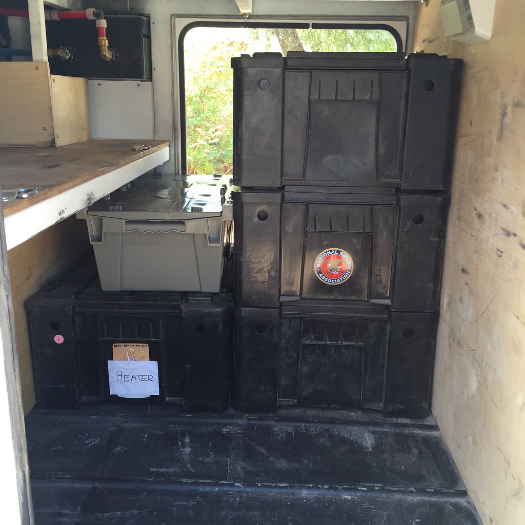

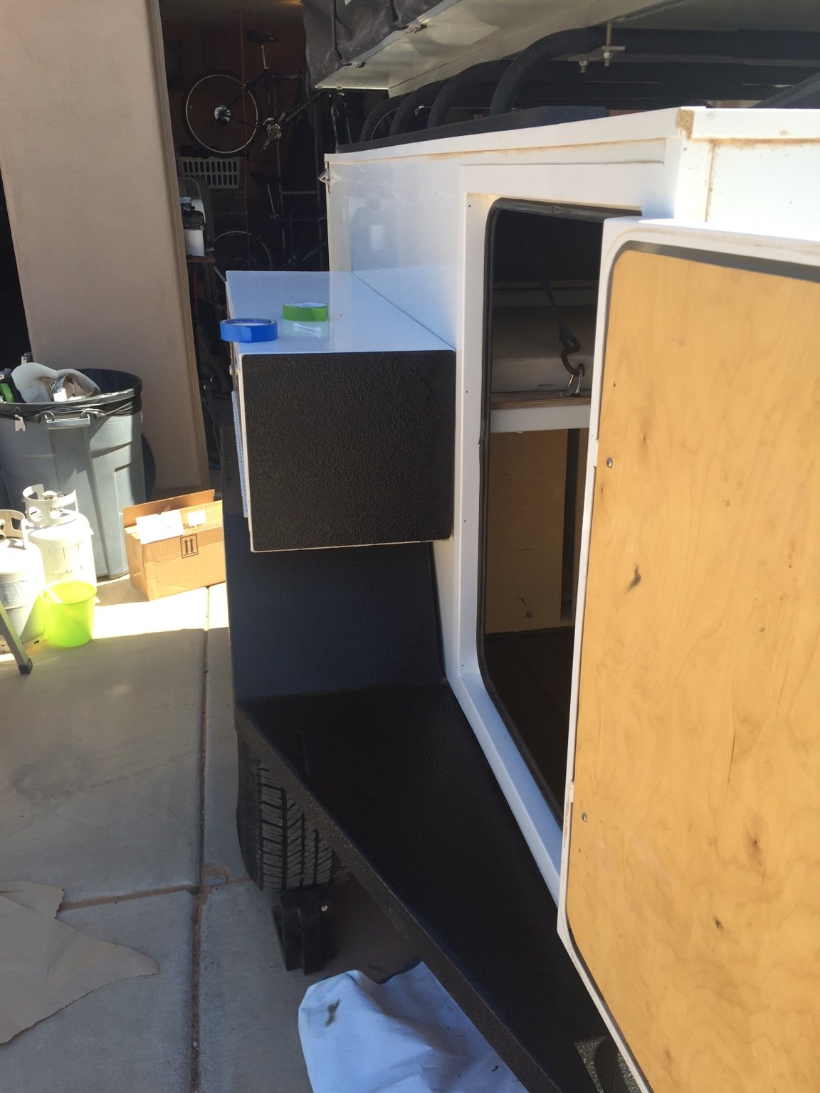

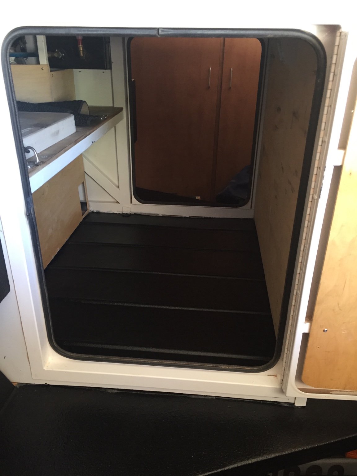

After a year and a half the cargo area in my trailer has some wear holes. Meaning the bedliner was worn down to the prepped metal. I originally did 2 coats. I probably should have done 3. Of course the interior of an offroad trailer takes a lot of abuse. Outside was fine. No issues with fading. Some minor chips. Again if you buy enough and are patient with applications it is a great product. Just make sure you have a full respirator because this stuff is nasty. Read and FOLLOW the instructions and any DIY'er can have great success. Adding another layer was easy. All the prep work is what is time consuming.
A simple solution for the interior of my trailer will be to put a $3.00 Harbor Freight moving blanket on the floor prior to loading all of my gear.
Here's a before pic prior to the recoat: You can see the wear and tear. Granted my trailer has well over 10,000 miles on it including trips through the entire state of UT, ID, Baja, and lots of other off pavement adventures.
