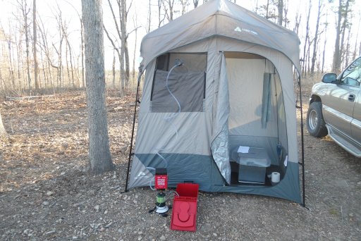

done some macgyvering this morning on our Zodi hot shower system. Got rid of the original 6v. pump (4 D battery) set up & went with a 12v. pump so it can plug into my tongue box 12v. outlets. The electrical cord for the 12v.pump that plugs into the tongue box outlets is 15ft long now. I added longer water line to shower head that is 12 ft. in stead of the standard 7ft hose. I also order a new 1 lb propane bottle base instead of using the lid as the base like it was designed, this way I can keep the lid on the container. Everything still fits into the original container too.
View attachment 48949 View attachment 48950 View attachment 48951 View attachment 48952

Awesome upgrade ! Are you happy with that shower I have been looking @ different options & have been looking @ this same one from Amazon.

Very good I appreciate the feedback & post . What type of pump did you use & where did you purchase from, and by any chance any Picts of pump location.Thanks again & have a great weekend.

Thank you for sharing. Just got my Zodi in this past week and definitely do not want to have to fiddle with D cell batteries so often. This will be so much better and the fact that it all still fits in the box is amazingly convenient.
