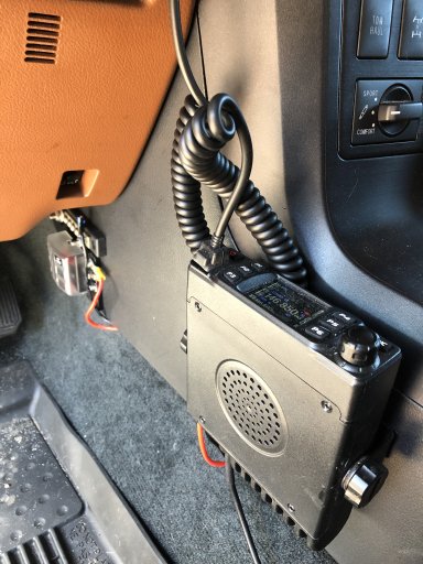

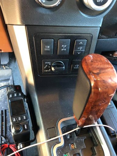

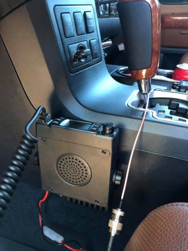

Found a spot where its easy to reach, doesnt foul my leg or knee, and isnt readily visible from outside.

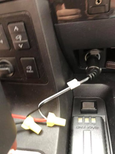

Photos follow. The wiring setup for now (temp) is wire-nutted to a pigtail 12V plug. I did this so I could work on antenna options and programming the radio, which is difficult on this model.

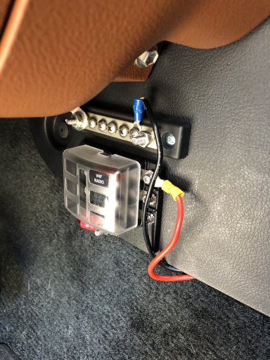

The perm wiring setup is awaiting parts I ordered. The wiring for the radio will run to a 6-fuse distribution block, so I can run other accessories from it as well and keep wiring inside the truck under control. The distribution block will terminate on a through-firewall connector. The connector I chose is 3-phase, but only 2 will be used. From the engine compartment side of the through-wall, the heavy-gauge wiring will run directly to the battery terminal on the positive and to the chassis ground on the negative side, so every circuit will effectively be a home run to the battery and the chassis ground.

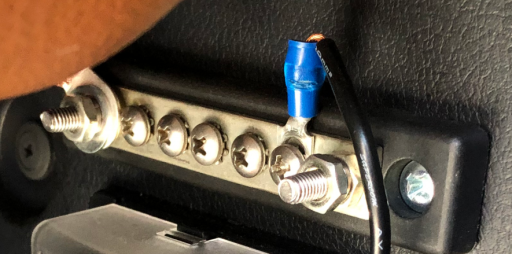

The inside negatives will terminate on this buss bar, which is connected to the negative side of the pass-thorugh:https://www.delcity.net/.../100A-6!Way.../p_801497.h_801498
All this is mounted underneath the dashboard in a convenient place.

And here is the temp connection: Dont use this permanently - any of the connections or the plug can introduce a voltage drop, impairing the operation of the radio.

My Tundra basically has the same center console/dash as your Sequoia, and my goodness I've been contemplating on mounting location options for my radio for at least 5 months now. I considered your solution before, but felt like it might get in the way of my leg or knee while driving. How's your experience with it so far?

In can touch it with my leg if I tilt to the right, but it doesnt bump under normal conditions. Maybe 1-2" clearance. Its about the only good location in this truck.

I have been using the rig with excellent results, but I finally got to running the power wire from the battery. The configuration now is an 8 gauge wire supplies power to a 6-gang distribution block. The block will allow me to run other circuits. An additional 8 gauge wire runs from a ground buss bar
to a chassis ground.
I then installed forked terminals on the rigs power wires and connected to the fused distribution block and to the ground buss bar.

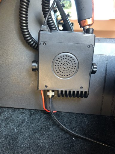

I tucked all the wires under the console skirt for appearance. I will put a little black flex conduit on it so they dont show.
Heres the final result before the conduit goes on.

The rest looks good. I am installing a Blue Sea fuse block with ground in the rear of my Jeep for radios and a few other things. Much cleaner than running 3 complete radio wiring harnesses to the battery.
