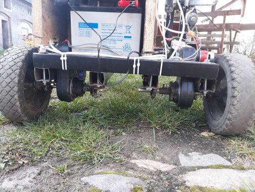

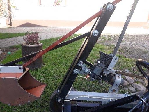

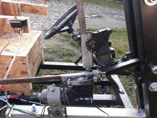

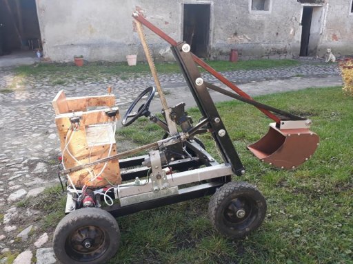

Please take a look on this little excavator, that I made for my son.
I think you can see on the images how i buld this vehicle.
Please ask if there are any explains needed.
Check attached link to watch it works and if you like it click icon-256x256.jpg
Please let me know what you think about this toy, or what would you change in it.

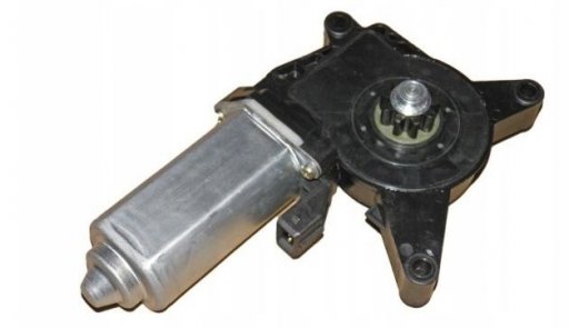

Good job repurposing the window motors. It appears you added a gear to the motor's with matching rack's.
What I would do diffrent is neatly route the wiring. Encase them in either split loom or a sheathing and tie it down. Box in the bottom of your joy stick switch and possibly run the rack gears through a rubber seal.
All of my suggestions are cosmetic. Overall, not bad.
