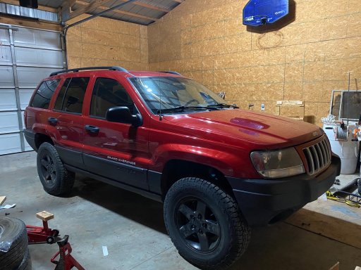

I’m in the process of building out my rig for travel and off-road mobility. I installed a 3.5” lift from rockyroad outfitters in Denver. It uses OME HD springs and a spacer combo. It came out higher than 3.5” but hoping after a bit of settling and heavy bumpers/tire carrier/winch that it will sit a bit lower.
Dealing with death wobble when I took it in for alignment. Hopefully it was the alignment/wheel balance or a simple fix like drag link rod-ends. Parts that I installed with lift:
Front LCA’s
Coil springs front and rear
New shocks front and rear
New spring isolators front and rear
Rear sway bar link drop mount kit
Front sway bar disconnects
Adj trackbar
Front bump stops and extension brackets
245/75 R17 takeoffs from a JK wrangler

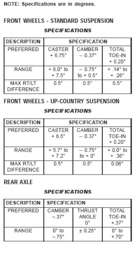

Build update: Jeep is back from alignment shop. Caster angle is a bit high and here's why. Lift came with longer LCA's to account for caster loss with lift. I ended up having the shop pull off the 2" spacers so I ended up with right around 2" of lift and am still fitting 245/75 R17's ok. (they rub a little on the front fender but new ARB bumper will solve that) I was getting more than the 3.5" of lift that was advertised, I suspect because I swapped in brand new spring isolators on the bottoms (didn't run them on the top with the spacers). Ended up pulling the spacers and putting in the new stock top isolators. All in all I lost about 1.5" of lift. Drive shaft is no longer creating noise and no death wobble bringing her home at highway speeds. Caster angle shows 8 degree's from the shops print out. Because my driveline angle is now less severe than it was with the spacers, I've opted to replace the rezeppa joint on the transfer-case side of the front shaft (boot/dust seal is gone). A brand new joint is $40 on the aftermarket, compared to a $500 dc driveshaft, which may require me messing with pinion angle and in-turn the caster angle. I'll post pictures of the Jeep soon. Also saving $460 on a driveshaft replacement helps me justify ordering that ARB bumper and winch setup that's just been sitting in my 4wheel parts shopping cart!

Nice! I don't think you'll mind ~8 degrees of caster TBH. The spec is 6.5* with a range of 6.0-7.5*.
With as much lift as I ended up with in my WJ (best I can figure, about 7") and using JK axles I had to cut/rotate my Cs and we went for 7.5. Then again, I'm running hydro-assist so it overcomes the extra "weight" of the caster in the steering wheel (and then some). In general I'd always rather have a bit too much caster than too little.

Mine is right at 6.5, 6 leaves steering to light and prone to DW, just over 7 is where driveline vibration becomes detectable. Quit while I was ahead. Have a bit of noise coming from the T-Case, but it has 230k on it so not surprised, thought about changing to a part time transfer case, as the Quadra Drive is a pia to rebuild, but is really nice to have full time four wheel drive for Michelle to commute in the winter. Will probably go with a rebuild when it finally gives up the ghost.
