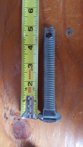

I thought I would share my DIY Maxtrax mounting solution. If you have an angle grinder, this will cost you ~$7 in hardware (not including a padlock). I'm sure this will work with other bed rail systems, but the dimensions might not be the same for the hardware.
Hardware:
(2) 5/8" Galvanized carriage bolts
(4) Galvanized nuts
(4) Fender washers
Instructions:

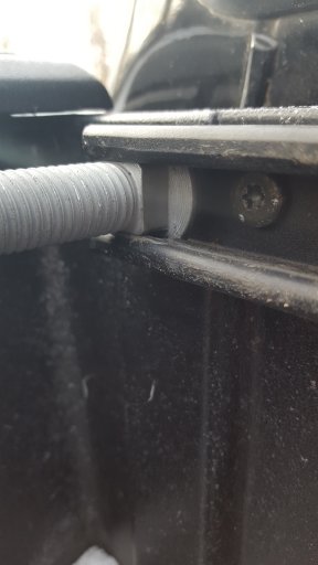

The bed rail slot is 1" tall, so you need to grind down some of the bolt heads on both sides for it to slide in. Make it line up with the square part of the stud so it will slide in the rail system correctly.
Next, figure out how long you want the stud to extend. I left room for an additional set if I ever get them. Make sure to account for the nut, and leave about 3/4" to drill a hole for a padlock. Thread a nut on, then cut the stud to length. Also, grind the last 3/4" or so of the stud flat so you can drill a hole. Do both sides unless you want to break some drill bits like me (the bit will catch the threads when it comes out and snap smaller bits). Use a punch to prevent the bit from walking when you start drilling. When you are done grinding, unthread the nut to remove any burs left from grinding.
The bolts can now go into the bed rail. I used the Maxtrax to eyeball where to tighten them down. I used one washer then a nut for each.
Now you need to grind down the last two washers so they fit the contour of the Maxtrax. I just eyeballed it until it fit.
Now put it all together.
