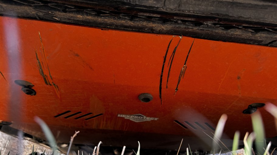

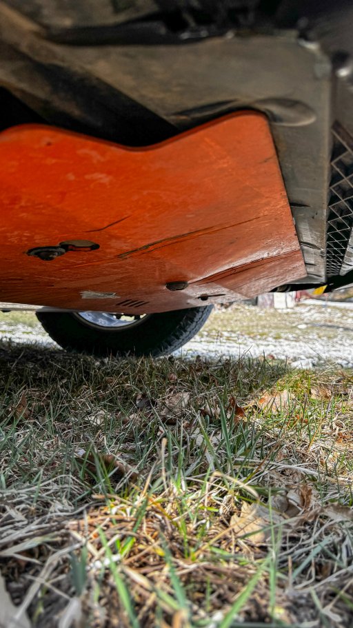

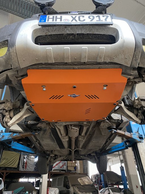

On a 12 days multi day adventure to the West Balkan I had an impact on my skid plate. And while crossing a river I have quite a bad impact to my steel skid plate.
I know that I need to change the overall design because the current one is way too short. You can see it ends behind the cooler which isn't good and caused the dent to bend the cooler.

The plates that you are showing on your Volvo are on the thin side 3mm or 1/8 of an inch it appears. I use full underbody aluminum plates that are 1/4 inch thick (over 6mm) and I have routinely scraped across boulders with them and while there are some scrapes there is no tearing or breakage. Steel armor for Jeeps will be more robust than aluminum but are still also typically thicker than your skid plate and are around 3/16 of an inch or around 5 mm. For my application the aluminum full body plates I used were significantly lighter than the steel counterparts by around 200 lbs or so. If you're not using a substantial full underbelly plate and just protecting the front approach I don't think the weight matters either way but I do think you should see if you could source or fabricate plates that are thicker and more durable than your existing armor.

Engineering says, strength comes from construction not material thickness. Your skidplate is more or less 3 flat surfaces that can individually be deformed easily.
The skidplates from the Chevy Colorado bison are a nice example for strength through shape and geometry, try looking at it.

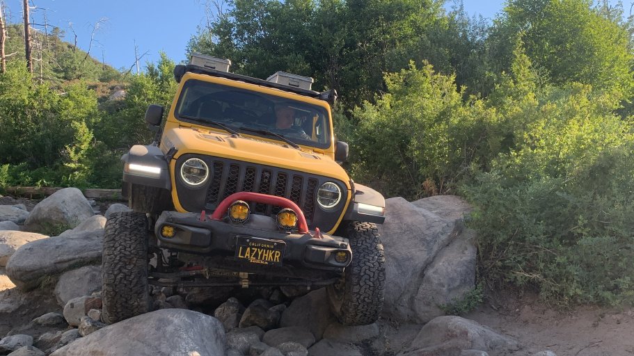

However, 6mm aluminum seems to do a pretty good job on a Wrangler JKU even if it's just flat material.
