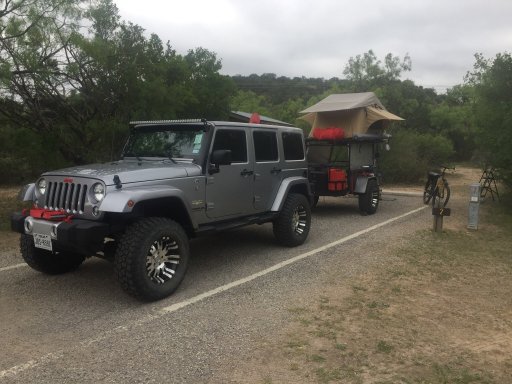

You can't go wrong with the Jeep Wrangler JKU (four door). Loads of room, and room to grow into as your needs expand and maybe the family grows. I have a 2015 JKU 6 speed manual (never had it in 6th gear) and I'm more than satisfied with the set up. Yes, I would like a lower gear set up than the stock 3.25 gears, but unless you are purchasing New -they are hard to find. Like you I'm not interested in a Black Bear Pass set up, but so far (4 months last year and 5 months this year) traveling in Colorado, New Mexico and Wyoming back dirt roads and highways up and down mountain passes, even pulling my Morris Mule Trailer, I'm satisfied. I would not be satisfied if the vehicle was an automatic. B&M short shifter would be a great upgrade.
Hope this helps

BobView attachment 62656
Thanks Bob! I feel like the Wrangler will give us some perfect growing room for the future. I'm interested in how well yours pulls the trailer as the gearing is a bit of a concern for me regarding whether or not I end up acquiring a trailer to take with us on trips. We'll probably appreciate the additional storage at least at first while we slowly ween ourselves off of certain creature comforts for different trips.
