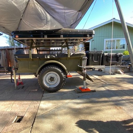

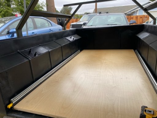

Hey mark . we custom built the rack to allow for the custom waterproof cover. We designed the rack to effectively not interfere with the cover so it does not lose any of its waterproofing in order to keep the inside dry. We opted for the cover over a solid cover to allow us to be more versatile as to what we can load in the back. As far as for the bed slide. We purchased the slides on amazon it’s a 56 inch 500lbs capacity locking slides. As far as the awning we are also mounting a strut assisted mount. It will keep everything low to keep lower center of gravity on the rocks. But when we deploy camp it will rise the waning to a reasonable hight to keep us shaded. Our main goal with this build is to keep everything as functionally low as possible.

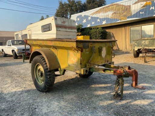

Very nice I've been toying with the idea an M416 for a little while. What is your set up for the hitch? I see the sample you have has the pintle eye removed and the tongue modified for obvious reasons. Are you planning to go to a ball hitch. My concern has always been hitch / tongue alignment. I know they were originally designed to be towed by a vehicle with a hitch height of about 3 feet off the ground. Maybe I'm just overthinking it but I worked for a contractor that had non modified versions on a job sight years ago and if you tried to tow them with a low hitch they were nearly uncontrollable. I enjoy fab work and thought they would be a great base for a project. Very nice work by the way it looks great!

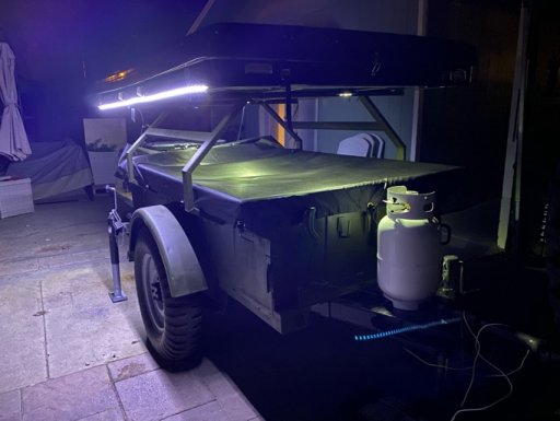

Good looking set up I really enjoy these builds . I really like the wheels you are running are those standard on the m1105? . we also just finished ✔ our lighting as of tonight here are some pics.
