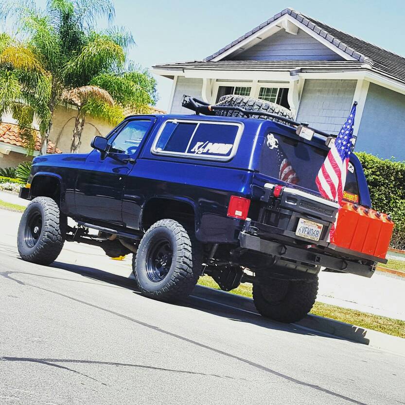

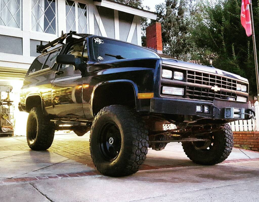

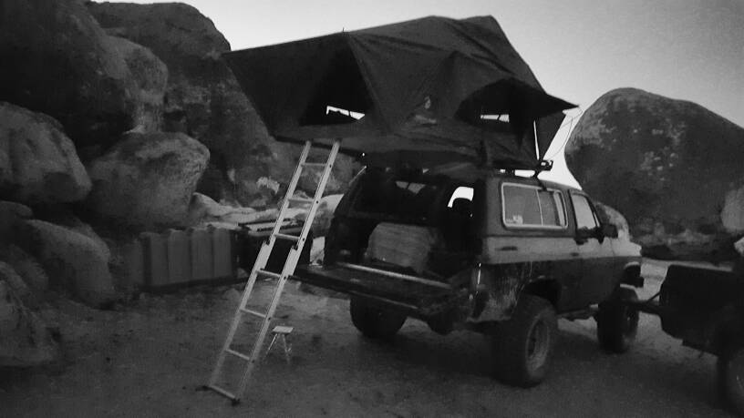

Alright so here's my rig. A 1990 K5 blazer with an LS swap and one ton axles. Immediate future plans are a custom coilover long travel setup in the front. Next up is to modify my roof rack and rear bumper to hold my rooftop tent and whatever else I want. Also planning on how I want to build out the cargo area of the interior. Thinking some type of drawer system?
Goal with the truck is to build it to serve 2 purposes
1- to blast through the desert with my friends
2- to take my wife and I anywhere we want to go.
I like being prepared and I am a neat freak when it comes to organizing and securing gear.
Anyways I'll be documenting my build as I go along. I really plan on tearing into it in the beginning of March.

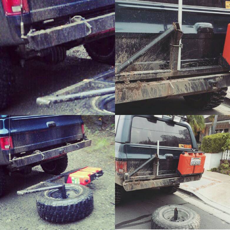

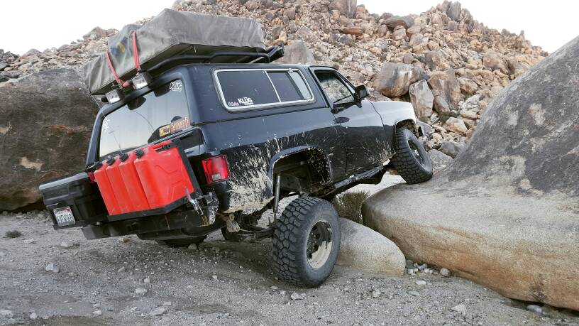

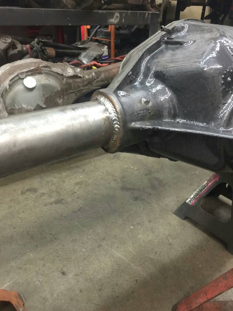

When you have a "fab shop" build you a bumper
Alright so I'll stop for now haha
gandrimp
Fab shop severely misunderstood what your intended usage of a rear bumper system required. Hope that didn't happen going down the hiway.

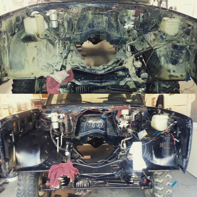

So, why the older model front clip?
Yes, yes they did. Worst part is after it broke once I tool it back to them to fix it. And then it broke again. So I fixed it myself. Now I don't have any issues!
I've always liked the older front clips. I've wanted a 73-75 k5 for a long time so I decided to convert.
Beautiful rig bud, I'm a huge K5 fan! Very nice!!
Sent from my XT1254 using OB Talk mobile app
Thanks man! It's only going to get nicer! Hopefully... if I can avoid rocks

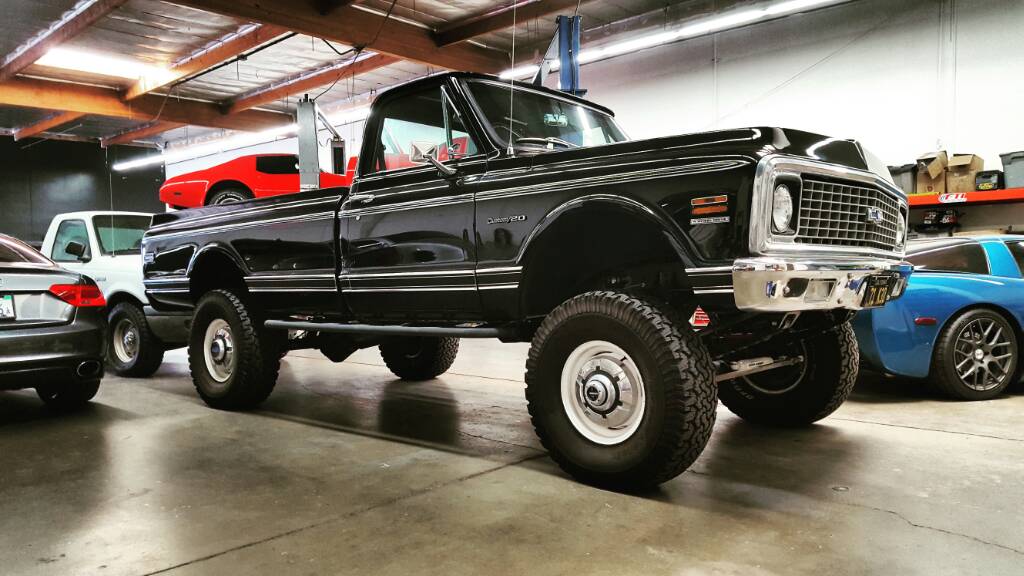

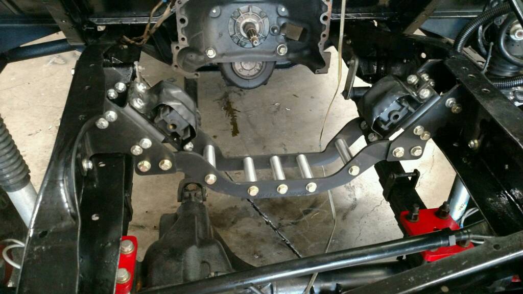

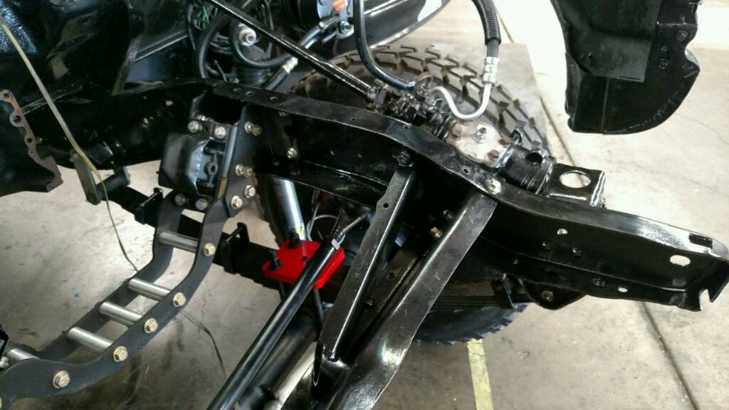

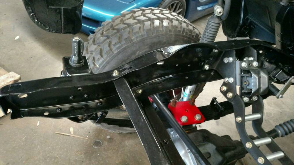

Since I've been gone my dad and friends have been working on the 71 K30. I'm building this one as more of a daily driver vs the k5 which is going more towards a wheeler. As of now the front frame had been ground and POR'd and the new crossmember installed. New wheels and tires installed as well

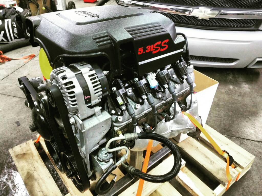

That's the all aluminum LC9 with the TSP stage 3 cam. Made 444hp and 406tq!

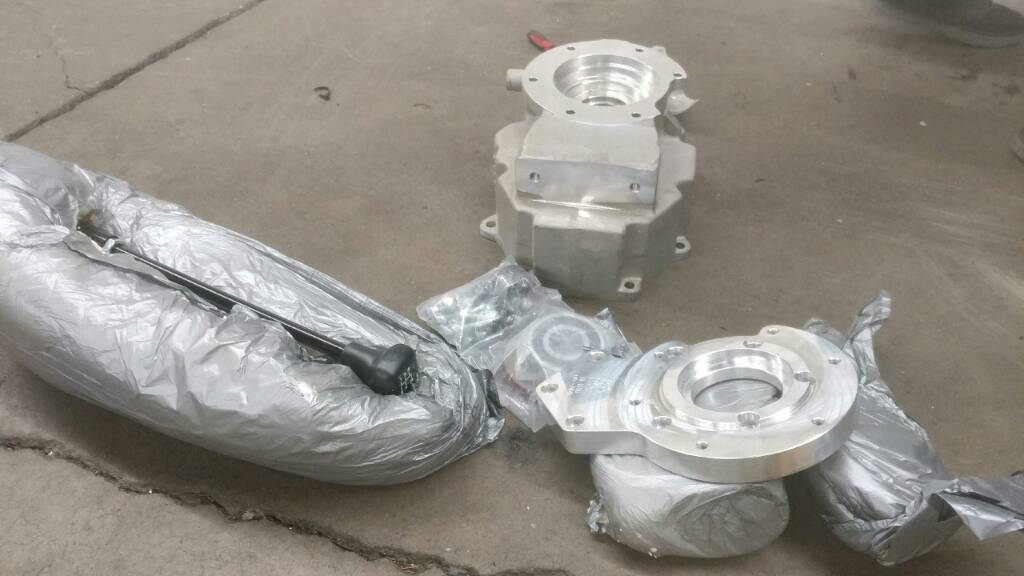

The adapters and bellhousing for the nv4500 and hydraulic clutch.
Only pieces left is a fuel cell and VSS adapter and vintage air. Parts have been ordered and should be there soon!

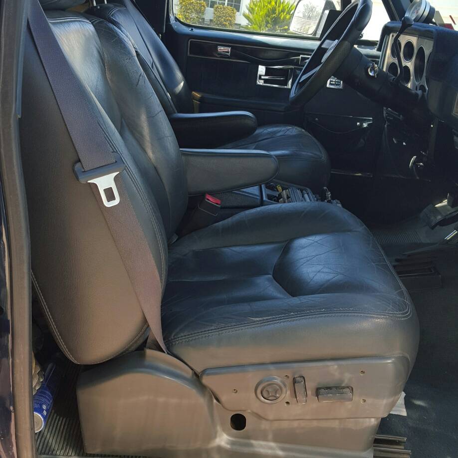

Man those are some rides you have! LSx K5 with 03+ seats nice!!
Thanks man! Yeah the seats are sweet for the long road trips. Was able to hook up the power and the seat heaters too! Only downside is while offroad they don't hold me in very well. I'm moving to an offroad bucket seats eventually
