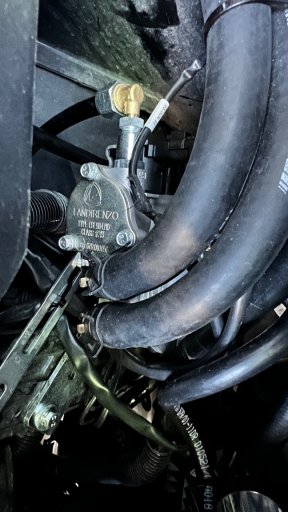

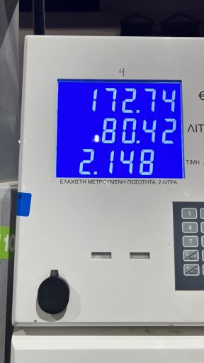

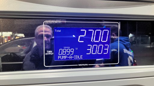

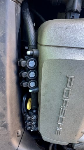

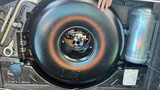

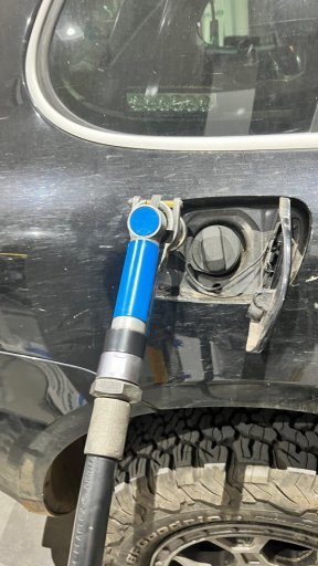

Thank you all for your suggestions and information provided. Currently the LPG system is under construction. It is quite sophisticated with its own computer, fluid propane reducer and injection becks. All Italian. Please see photos. Will let you know about performance once I test it.
