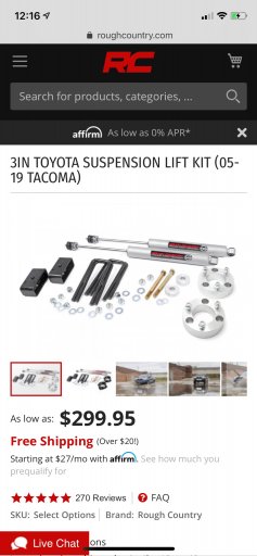

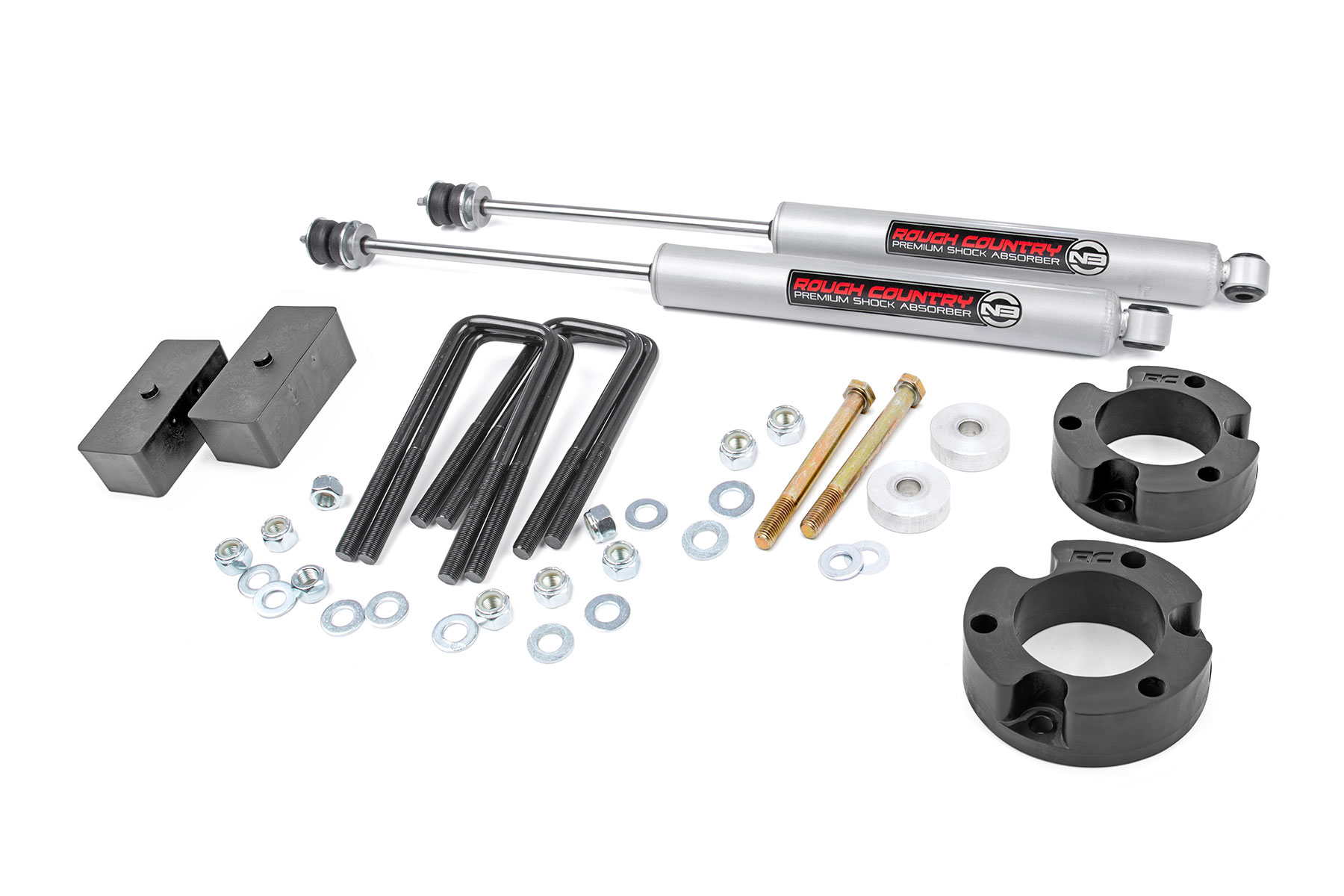

I have a 2017 Tacoma TRD Sport. Looking to put a small lift and upgraded tires.
Does anyone have experience with the below lift kit?
Any recommendations on tires that can perform well on mild trails but don’t create much road noise?
This isn't a real lift. While it will lift it, it doesn't increase wheel travel. You can get over taller things under the car but you don't get the advantage of a better springs and shocks. So it depends on what you are trying to accomplish. Lifting for looks this will work for offroading something like this Coil/Bilstein 5100 Kit (HS16BK-1) is minimum.
I want the look, of course, but also trail performance. I will not be doing technical trails in this, as its my daily driver, but I plan to do some mild off roading and logging/fire road exploring. Hoping to keep the wheels & tires, lift, and bumper upgrades under $3k.
I would recommend a short lift. Factory springs and shocks are ok for pavement use. Any off-road travel or carrying a load and you'll want to upgrade. I recommend Old Man Emu springs for sure. I have heard good things about their BP-51 shocks, but they do not make them for my application, so I went with Bilstein 5100's. I have the heavy duty rate springs, but you could probably get away with medium duty depending on your plans for adding weight. I know I planned way ahead for the added weight, but I'm glad I did. And I think all in all, I've spent $1k on the lift. That's including needing to replace parts due to the age and wear of my vehicle. I would not skimp on the quality of the lift. I have seen people go budget boost many times to only upgrade soon after. The performance and quality lack.
What are you looking for in bumpers? What is the purpose? Changing them is for offroading to prevent damage to factory ones or to allow more clearance for bigger tires. To me they seem very overpriced for what they get you. Look for other ways to accomplish your goals that are less costly and put your money into performance or usability upgrades. The appropriate lift kit, Tires, recovery gear, maybe lights. Look for the bigger bang for the buck. I think you will be happier.

Bumpers are crazy expensive if you ask me! I do want some protection from large obstacles but you can spend my entire budget on bumpers. I think you are correct. For my purposes, light to medium trails, I can get more capability from other upgrades.
