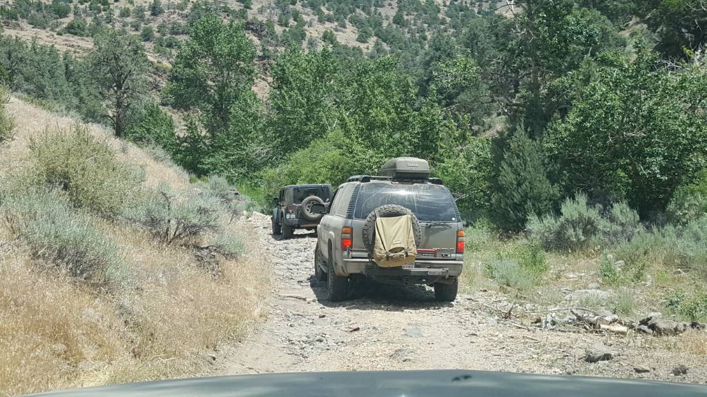

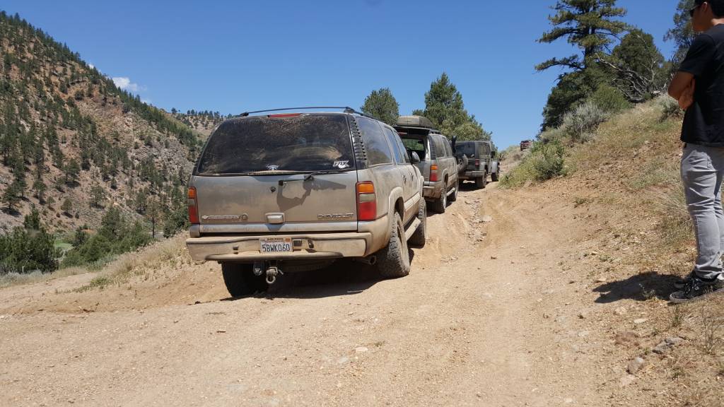

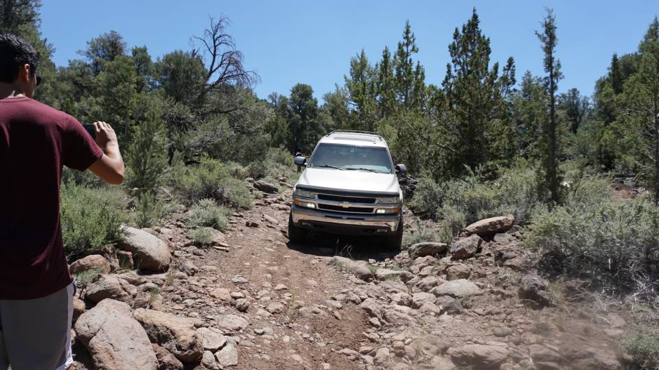

From first hand experience I gotta disagree. With a moderate lift good tires and the G80 locker the Suburban went everywhere a Jeep JK, Tacoma, 4runner and FJ did on a recent trip and did so mostly in 2WD with G80 equiped Z71 and 2500 Suburbans.
I will say with any full-sized truck and SUV you will get pintstriping, not be as agile and will be moving at a slower clip.
The 2500 Suburban in particular has really stout (HD) engine, trans and rear axles. The 2500 platform also sits about an inch higher than the 1500 series. So depending at which platform I'd say at a minimum a 2" spacer (4" might be better) on the 1500 and leveled 2.5" on the 2500 with 33" tires with G80 locker and you have a really capable rig. I have been very surprised how well it performed off-road thus far. I feel like with that setup all moderately rated trails wouldn't be an issue. For harder trails 5-6" non toresen bar drop suspension lift UCA for more droop and 35" tires along with rock sliders would be mandatory IMO.
