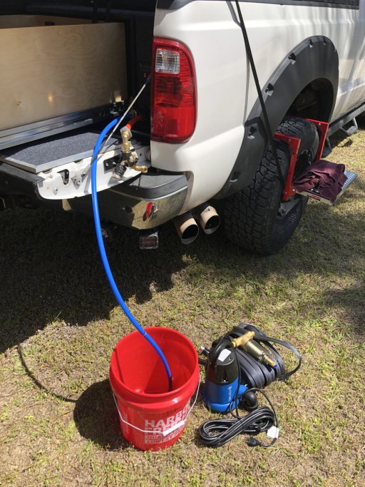

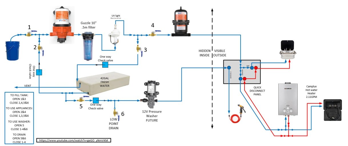

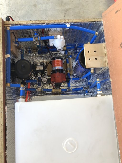

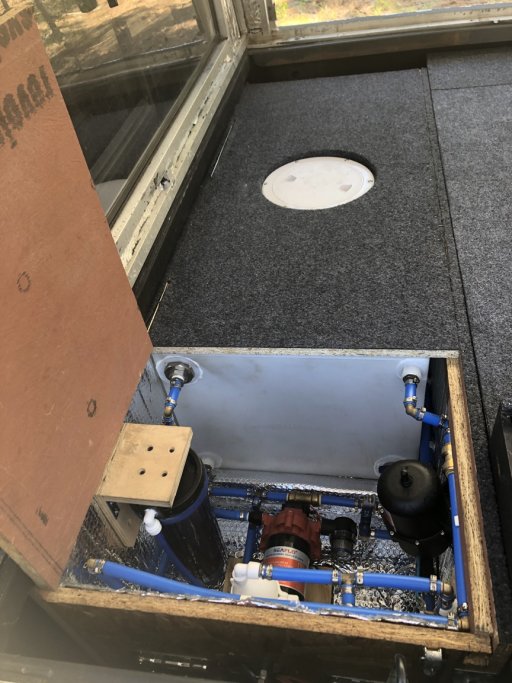

Sounds like you will have fun. I can talk about water as I think I have figured out a great way to not worry about it.
GuzzleH20 has the idea that you can convert to a setup in your Class A. A little ingenuity goes a long way. I did not buy theirs but created my own.
Think this way:
I want to fill my fresh water tank from “any” water source within 50 feet of the rig. Lake, 1” deep stream, pond, river, creek, etc…
Drop a “sump pump” into the source water to lift it to a bucket by your rig. Now you have to plumb in either a line to the onboard 12v pump or plumb a new pump into your fresh water lines. Then just drop the intake line in the bucket!
Proven concept in my rig!
Standard .5 micron filter
UV light (most expensive item)
A great and well-designed system! What is the pump's flow rate when you want water for your appliances, and is the UV unit rated for that flow rate? I am asking because the dosage depends on the flow rate.
Do you use a mesh / paper filter to protect your pump and the .5 micron filter? Makes sense if you draw from a pond or river.

Thank you for your kind comments. The pump is rated at 3gpm. I will have to look up the UV light flow rate as I can’t remember. The process of drawing water from say a pond is filtered by a well pump sediment filter before it goes into the 5gal bucket. Then the typical pump strainer, then pump, then .5micron 5” filter, then the UV light. The only change I have done to the system is reducing the filter size from 10” to 5”.

UV light max flow rate is 2.2 gpm.
For a pump rated at 3 gpm, the UV unit's 2.2 gpm max flow becomes the limiting factor. If actual flow through the UV exceeds that rating, contact time drops and so does the UV dose — meaning inactivation of bacteria/viruses falls short, even though the UV lamp is technically running. The fix doesn't require to change the UV: add a flow restrictor or partially close a valve before the UV to bring flow at that point down to 2.2 gpm. Most 12V pumps can handle the added backpressure.
