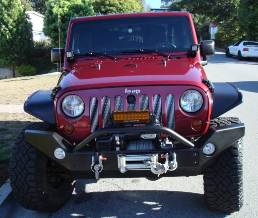

When I still had the last jeep I mounted Pillar lights and slightly canted them outward to illuminate the sides of the road and mounted a 10" rigid light bar on the bumper. Its pictured with attached fog lens, but it pops off if need be. The only time it really glared was a very bad down pour coming out of death valley at night. However the amber cover still pierced the rain and did not kick up any glare.3.jpg
