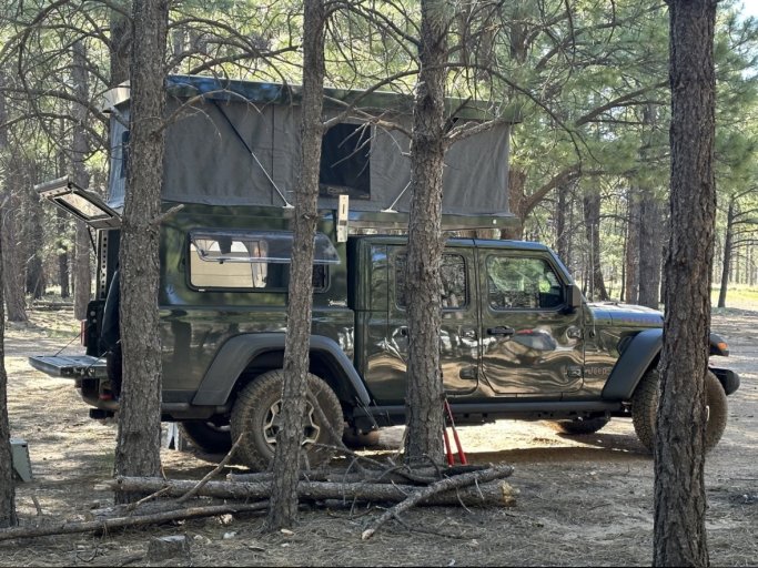

AT Overland Atlas on a gladiator!!!
Yeah it’s a topper and i think you are looking at a slide in. I got excited and I was drooling over it as I like the full roof lifting principle and the possibility to keep my kitchen boxes!

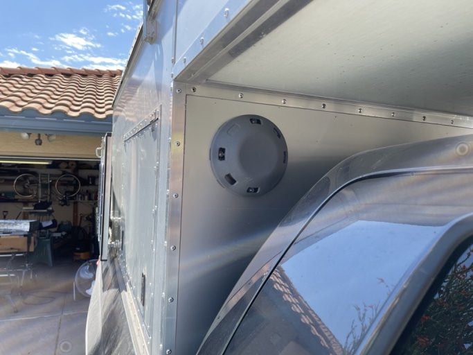

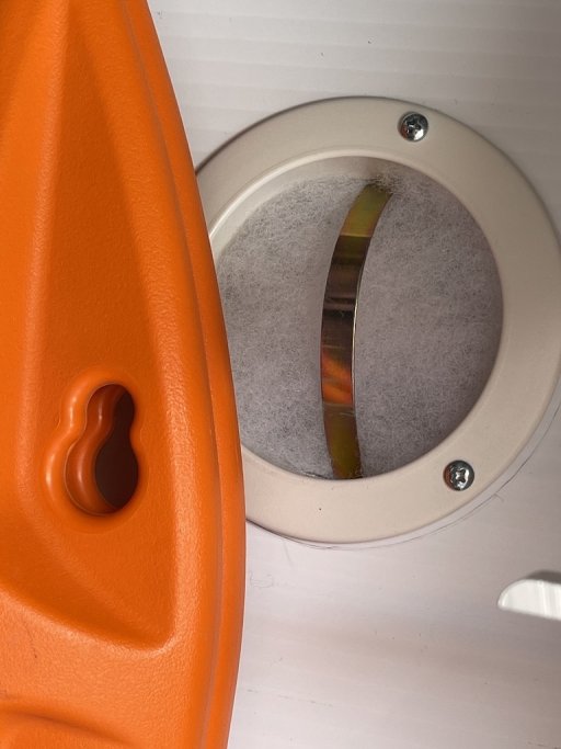

The other thing that makes a big difference is a positive pressure vent. This is from the marine world adapted to the camper and is completely waterproof (designed for horizontal deck or hatch venting which get drenched on a boat), even at the car wash. Reduces the suction that the big square butt of the camper creates which draws in dust.
Inside outlet with air filter
