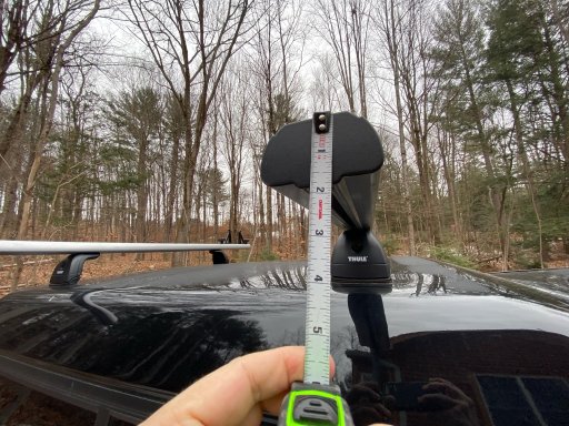

Hi, noob here and just starting this journey. I have a 2020 Toyota Tacoma with a oversized (height) Leer truck cap that has the integrated Thule rack system (500 pound static load). I'm looking to buy the oversized 270 awning system and mount that to as big a basket I can get for the truck cap. So looking for a recommendation for the basket. It will be primarily for storage of gear while in transit (camp chairs, a few watertight bins, things like that) and the mounting of the awnings.

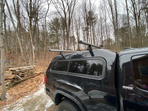

Thank you for the recommendation! My only issue with the Tiger is I have thicker crossbars (got the cap in the pandemic so wasn’t aware there were different sizes). The width is fine but the thickness is bigger than the max 1.05” (it measures 1 3/4”). I’m assuming I can simply swap out the bolts with longer ones?

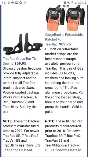

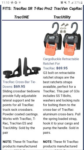

Ah! I didn't chime in because I figured Grub had this handled. Now I'll be paying more attention. Looks like you have the cross bars that came with the Trac Rac Cap Rac, which is what I have. Trac Rac was bought out by Thule a few years ago. You may be able to find something Google-ing Cap Rac or Trac Rac cross bar compatible. But still be wary. When under Trac Rac, those racks had ASE/ imperial hardware. When Thule bought them, they went to metric sizes. Depends if you have Thule or Trac Rac version.

Yakima stuff and Thule stuff are seldom easily compatible.
You may want to try the Thule Canyon XT. It does have a T-bolt attachment option, which should fit into the same groove that your cross bar tie down "bookends" fit into. It only has a 150 carry capacity, though
