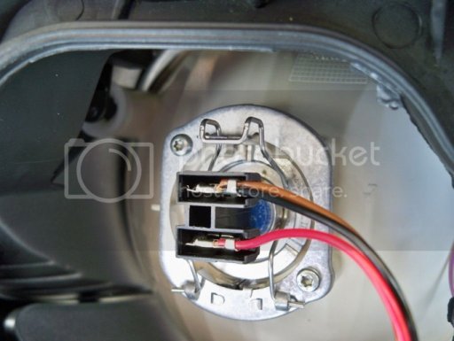

I have a 2008 dodge ram 1500 that I am trying to find headlights for. The only problem is that my headlights are aftermarket the low and high beam are split, and with the retention method uses spring wires instead. The bulbs are h7 and h1 for the high and low beams respectively. If anyone has found something that would work id be very appreciative!

The problem is they are not my stock bulbs because the aftermarket headlights

Take the bulbs out and get the part number off the bulb. Shouldn’t matter what the housing is if it’s the same bulb part number.
