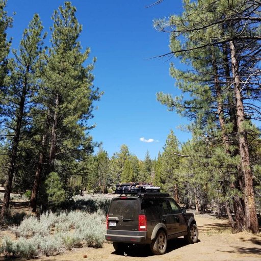

Finally took the LandO out for it's first off-the-grid capping trip. This thing is amazing! Thanks to everyone that offered suggestions, advice, and opinions. We are totally impressed with the LR3 and can't wait to make more modifications to it in the near future! See you guys on the trail! [emoji106] IMG_20180617_200337_223.jpeg20180616_150654.jpeg20180614_133823.jpeg20180616_142742.jpeg
