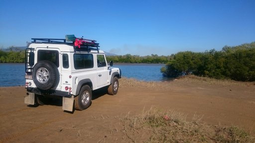

So far all I have done is add an APT fabrications bull bar, a tradesmans roof rack to which I have attached a jack and shovel holder and ARB awning, a rear ladder and a rear recovery point.

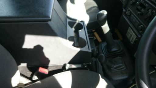

I also have a Mulgo ExBox, which is a box that goes under the cubby box to house all the electronics and frees up space under the drivers seet for starage. However installing this and the CB radio with it will be a big job so naturally I have been putting it off for months, hopefully I can get onto it soon.

Today I installed the ExBox which I mentioned previously I have been putting off for a while. All the electronics are now nice and high up away from water, my CB is installed, I added a USB and a 12v socket and there is a large storage space free under the drivers seat.
