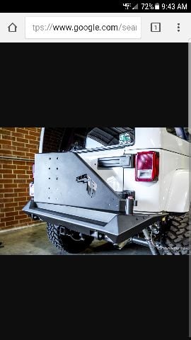

Ok will do. I have a 2010 jkur with that 3.8. I have a full carbon hood on it so yeah hood won't be an option for me either. But I do have fab fours bumper front n rear with the old tire carrier. I saw they came out with a new version that bolts in the same local but us timed to the gate. It's at a 45° angle . So thinking of mounting it to that. Unfortunately I don't think the aev bracket will work since its for round tube like the old swing out carrier. The new one is flat plate.
