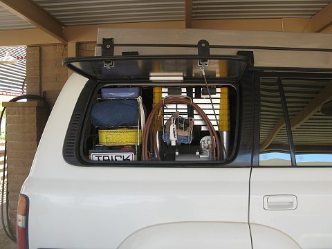

I carry all of the above and keep the Yellow tow strap (see below) and a D ring available for quick access. Normally time is not critical when a Kinetic's are needed.

I love those side opening windows. I wish someone would make a conversion for the rear side glass on the LR3/LR4. I have a rugged ridge tow strap. It doesn't have any give. I also have the standard metal shackles. I'll put some things on my xmas list. :D
