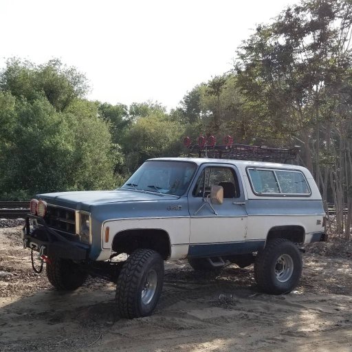

Looking for some feedback or thoughts on whether or not this type of vehicle is so.ething to get stsrted in.
1979 Gmc High Sierra
400small block less than 3000 miles
Dana 60 front and rear.
Tubro 400.
drive train in out standing condition. Only draw back is carburerated..doesnt do well in high elevation.
Im just getting my feet wet, but would really like to test myself and the rig.

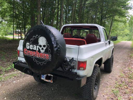

Also from the looks of the pictures your K5 seems to be running a Dana 44front and a GM 10.5" out back. Hard to tell for sure without a picture of the front hubs and the rear differential though.

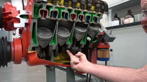

All SBC's have "Siamesed" cylinders, not just 400s. To say that coolant doesn't flow between the center cylinders is pretty inaccurate. There are cooling jackets around all of the cylinders and around every port in the head, here's a cutaway showing that:
What "Siamesed" means WRT the SBC is that the center two cylinders have their exhaust ports next to each other (note the "red" ports in the cutaway are exhaust, blue are intake). People really make that out to be more of an issue than it is. Yes, it does create the possibility of a bit of a hot-spot in the very center of the head, but this has little/no impact on overall engine cooling. What it DOES impact is the potential for detonation in the center cylinders, but especially in carb'ed applications the intake manifold design tends to lead to those cylinders being a bit richer anyway. That's not to say SBCs don't have cooling issues at times, but it has nothing to do with the intake/exhaust port layout of the heads.
Also, looking at the OP's pics I see 8-lug axles (and what appears to be a full floater in the rear), that rules out a 10-bolt rear. I assume you meant 10-bolt, not 10.5". The 10-bolt had a 8.5" ring gear, even the 12-bolt was a 8.875" ring gear and wasn't a full floater. The Corporate 14 did have a 10.5" ring gear, but I've never heard anybody call it a "GM 10.5 inch" rear. That said, it obviously is 8 lug and full-floater, so maybe that's what you meant? Either way the OP said it has D60s front/rear - and the rear 60 was available full-float so that seems to be the case here.

The Siamese cylinders are not the concern, it is the head gasket between cylinders holding up since the cylinders are very close together and there isn't a lot of gasket there. That concerned the hot rod guys upping compression, rpm, power, and pure abuse and the myth spread. A stock or near stock 400, not tortured overly hot, is SOLID. You would have to abuse it pretty bad to have any issue with a blown head gasket.
