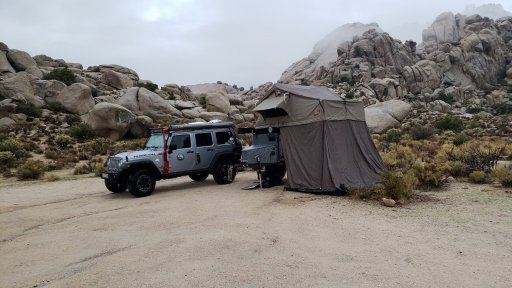

This past Friday night we slept in the Mojave Desert and woke up in the middle of the night to a complete downpour, had to pack up in the rain in the morning as well. When we went to set up camp at the next location on Saturday evening, I opened up the RTT cover and unstrapped the velcro tie down straps which resulted in at least a solid gallon of cold water just draining from the folded RTT and going directly down my sleeve. I set up the tent, hopped inside, and everything inside the RTT, including some sleeping bags we left stored in there, was BONE DRY. We've had at least three nights like this one and have never had the inside of the tent get wet.
To reiterate what @Cpol called out: Just make absolutely sure you let everything dry out as soon as you are able. @SwellRunner has a horror story in one of his videos where he forgot to air out his RTT after a very wet trip and his tent was ruined (at least cosmetically) by mold.
