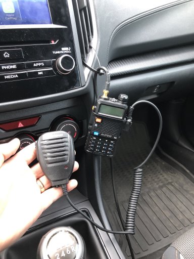

I have had my license for a few months, but really have just started using it. I have a very simple basic setup for now consisting of a Baofeng UV-5R with a mag mount antennae that is suspended via a zip tie to my vent.
F4483F99-5857-4A49-A4FA-537E471D3365.jpeg6CE52CEB-B773-41BD-BF3C-BE668F594BC8.jpeg5E9C5A78-4B95-4CC9-AB27-D70A2CEF8E32.jpeg
