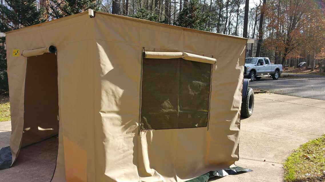

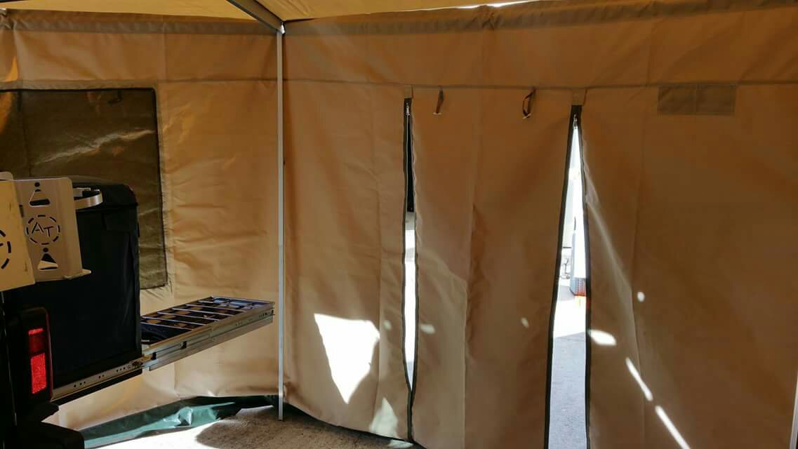

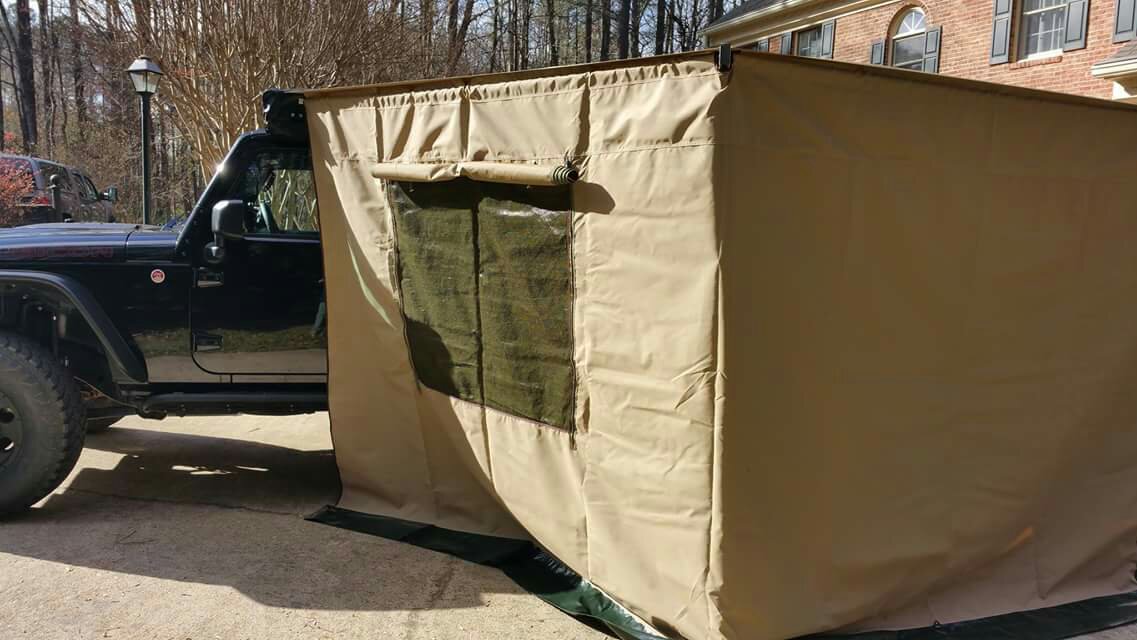

Not sure about that rack, but I love my Eezi Awn Bat 270............
That's a sweet awning!!
I like that awning a lot! I hope they make some type of bracket or probably will have to make one to fit the Gobie Stealth Roof Rack.

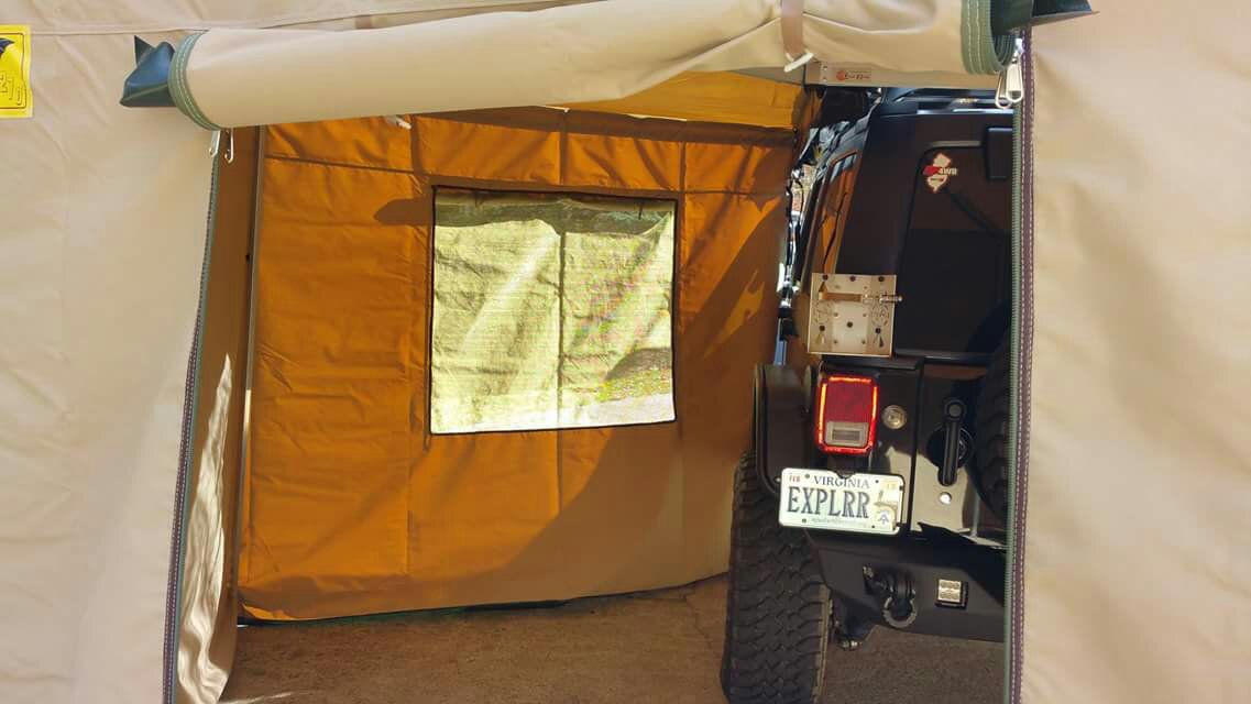

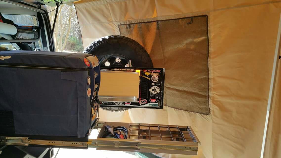

Great rig and great shots!! Love the idea of a "wing" awning and wonder if the tailgate bumps/hits it? Wonder if the rear canopy window of my truck canopy would hit/bump it ....thoughts? Thanks!!
No issues with my Jeep tailgate or glass raised. I also have the wall enclosures to make it a room.
