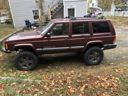

Looking at a 2000 Jeep Cherokee. It has a 4.5 rough country lift. Looks to be in good shape. Has a winch bumper. Has never been off road. I was wondering if anyone has a X J and how they like them.

Short arms isnt ideal but they'll work. Dana 35 is servicable but id keep an eye out online for a 97+ Chrysler 8.25. Typically they go for pretty cheap and if you find one in an XJ itll drop right in.I tried finding you on Facebook without success. Meeting my friend there later so he can look at the Jeep. Did talk to the boyfriend. Jeep has the rough country lift with the short arms. Is that a good lift? Unfortunately does have a Dana 35 with 3:55 gears. Will that axle hold up or will it break?
Tires that are on it don’t look much bigger then the stock. When I drove it there was no lag. If I put bigger tires on I’ll change the gears. Hopefully I’ll get the new axle.Short arms isnt ideal but they'll work. Dana 35 is servicable but id keep an eye out online for a 97+ Chrysler 8.25. Typically they go for pretty cheap and if you find one in an XJ itll drop right in.
What size are the tires? 3.55 is the stock gearing for automatic transmission XJs so you may need a regear if the tires are much larger than stock. I wouldn't waste the money on regearing a D35. Does it have ABS?

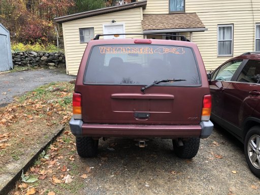

Keep us posted!!!!Made a offer, since there is some rot on the passenger quarter panel I offered her 1800 for it. She was asking 2000. Still waiting to hear from her.
