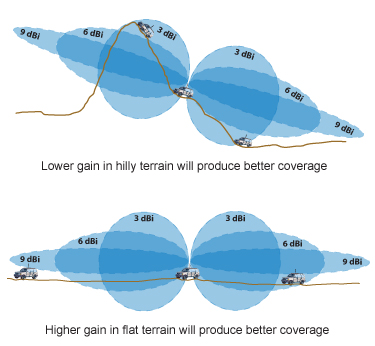

Pardon this dumb, question, but I have a CB in my rig and want to switch to a GMRS mobile unit. Would the CB antenna work on the GMRS radio?
You'll need a new antenna, a CB antenna wont' be resonant on the 460mhz frequencies. As for reusing the old mount I would just replace it with an NMO mount as the majority of antennas you will use for GMRS will be NMO antennas. For GMRS use I suggest going with a business band antenna in the 450-470 range since that's where GMRS is. A 70cm ham antenna will work but is less than ideal.
Here are my suggestions for an antenna. I've attached to a graphic that shows the radiation pattern of different types of antennas and you can get an idea of what would work better for you in different terrain. Don't get too wrapped up in antenna length or dB gain. Higher gain or a longer antenna isn't always better in many instances. Even though a longer antenna might look cooler it may not be the best tool for the job at hand.

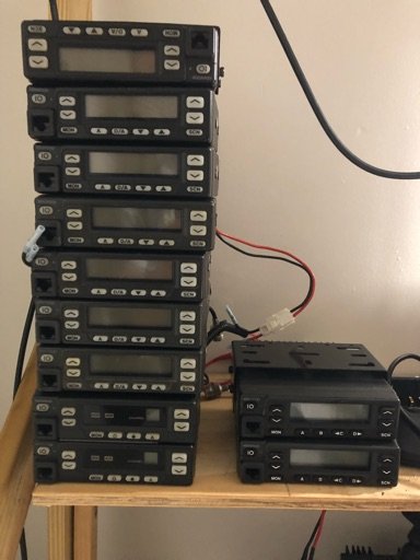

The one issue with the midland branded gmrs radios are that they are narrowband. GMRS is primarily a wide band service. While you’ll pay more for the midland for “ plug and play “. It will not preform as well as other choices available.
When it comes to programming a kenwood. I offer that service free of charge. Minus shipping costs.
You can spend 249 bucks for a midland mxt400 or spend around 150 or less for a complete and ready kenwood and be further ahead. I also build mobile/deployable repeater units for people.
Side note: I believe the newest revision of chirp does allow programming to a tk880 version 1.
