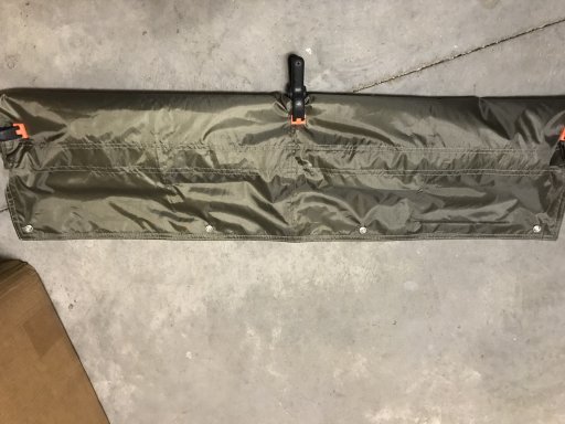

I had been engineering a way to build an awning that was light weight, and could mount to the soft top some how. I didn't want to just use bungee cords, or clamps and wanted the entire thing to look professional. I also didn't want to use one of the spare tire mounted awnings as they are shaped like a wedge and the shape limits the amount of surface area dramatically. Here is what I came up with.
My design leverages two of the snaps installed on rear, upper bow of the soft top from the factory. These are meant to be used with those lame elastic bands to hold the rear window when you roll it up. I've added two additional snaps, and used a light weight 210d polyester oxford fabric camping tarp with some modifications to develop a 6" reinforced "tab" that is 41" inches wide, located in the center. It snaps to the bow as the connection point to the vehicle. Then there is a long 1.5" wide pocket sewn into the vehicle end from one side to the other, that I can insert a fiberglass dome tent pole into, from one corner to the other. This pushes out the corners on the vehicle end and allows full use of the width of the tarp.

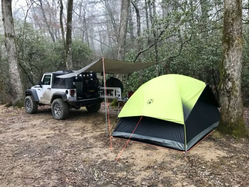

Just unzip the window and flip it onto the roof, snap in the tab, slide in the tent pole to make it rigid, and then set up the far end with normal tent poles, guy lines, and stakes. Done!
I haven't tested it this way yet, but I'm thinking that I could even fold it in thirds, roll it up towards the vehicle with the tent poles all collapsed and rolled up in it, and then strap it to the bow to allow it remain on the vehicle (inside, protected from the elements and trail dust).
Only caveat/design flaw so far is my CB antenna and hi-lift are mounted on the tailgate and will definitely rub inside the awning. I don't think it will be too big of an issue as they aren't super tall.
I just got it all finished up and tested today, and works great! I'm excited to set it up at my camp in two weeks at the American Adventurist Appalachian Rendezvous in Uwharrie!
