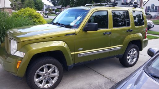

Liberty is extremely under rated. Very capable vehicle, but small. I've got a 2012 latitude edition. OME 1.5" springs and shocks netted me ~2.5" of lift and much better ride. Also running 255/60R18 Hankook Dynapro AT/M tires. Mostly use on the soft sand beaches here on Long Island, NY, and it's perfect. Here's a pic post lift, before the new tires:20160710_145935.jpg

MY wife bought it near new, been flawless (even Skyslider roof) and nearing 140,000 miles. Your truck looks good, don't see that color very often...Always respected OME suspension parts - used them on Rovers in the past. How are the Hankooks? Always thought they looked good....Been looking at the new Continental TerrainContacts.

Liberty is extremely under rated. Very capable vehicle, but small. I've got a 2012 latitude edition. OME 1.5" springs and shocks netted me ~2.5" of lift and much better ride. Also running 255/60R18 Hankook Dynapro AT/M tires. Mostly use on the soft sand beaches here on Long Island, NY, and it's perfect. Here's a pic post lift, before the new tires:View attachment 57602
love this color
