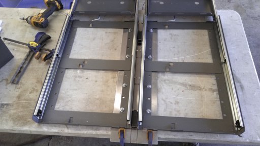

I have been looking at drawer systems for my Jeep JKU. I didn't want anything real tall that would take up all the space in back. The other challenge is the cost on many of the drawer systems out there was waaayyyyy more than I wanted to spend. Well I found a couple Black Forest slide outs from a scratch and dent liquidator for $60 each and decided to build my own. When it's done, it will only be 11'' tall and I can still put a cooler and cargo boxes on top.
My parts list:
Sliders- 2
15" x18" utility drawers from E-bay - 2
Spare ammo cans - 2
Walmart poly cutting boards - 2
Cheapo cargo mat from Walmart
Left over aluminum from other projects
Harbor Freight d-rings
A bunch of hardware from Ace
Parts pile
Spacers for the drawers cut from 1" aluminum square tube
Sliders bolted in the center to a 7" wide piece of 1/8" aluminum plate. I drilled 1/4" holes and pressed carriage bolts in from the bottom
Drawers bolted down to sliders

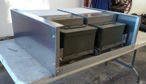

Just enough room in the back for the 2 50 cal ammo cans that will be held in place with nylon straps

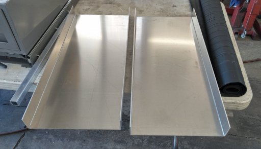

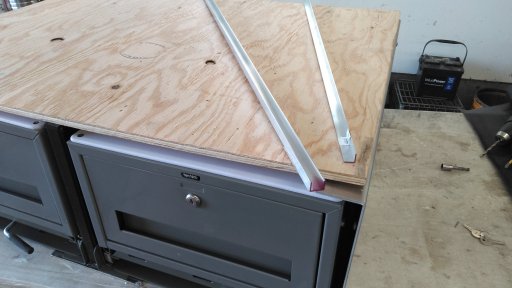

Going to bend up some 1/8" aluminum for the sides and build a center support for the plywood top.

I changed my mind on how to hold the ammo in place and attached them with a single screw into a nutsert in the back of the drawer frame. Remove one screw and the ammo boxes lift out. I built an L shaped piece to extend the sides of the tray behind the ammo cans. This area will be used to hold cooking oil on one side and tire sealer and WD-40 on the other. I lined the bottom of the drawers and ammo cans with some padding made from an old sleeping pad to keep things from rattling.KIMG0222.JPGKIMG0221.JPG

How did you bend the side aluminum, to such straight edge. Do you have access to a metal shop.

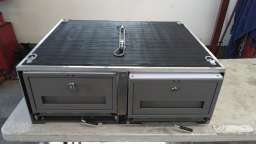

I got the center support built and the top on. I was looking for some aluminum trim to go around the edge but no luck. I ended up finding the perfect stuff in the metal rack at Lowe's. I cut it to fit, then drilled and counter sunk holes for scews in addition to using Liquid nails to attach it.KIMG0228.JPGKIMG0230.JPGKIMG0232.JPG
Trimmed the El cheapo Wal-mart cargo mat to fit and glued it down. I'm still fihghting a little bit with getting the rubber to stick.Then added d-rings and a piece of track with removable rings that I found at a garage sale. I got two of the short pieces of rail, tthe other one is mounted in the cargo area of the Jeep for when the box isn't in.

I had already upgraded the tie downs in the back of the Jeep so I used them to hold the box in place with turn buckles. It's very solid and 5 minutes with a wrench and the it's out.
Loaded with gear. One side is filled with recovery gear and the other side has rope, misc tools and parts, tarp, tent pegs, etc. A Coleman 2 burner fits on the driver's side and and a large ammo crate wth freeze dried food on the passenger side between the box and Jeep side panels. The back seat is still functional for the dogs.
