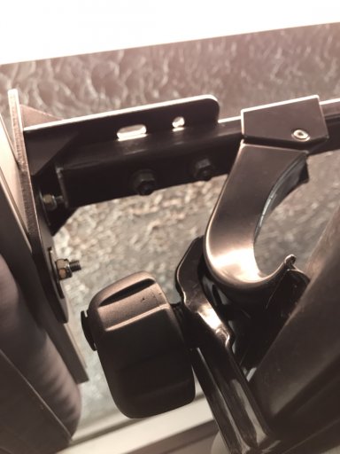

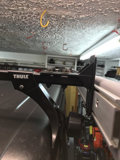

@GrnRubi, take a look at how I did my awning. Yes it’s a roof rack, but the old fashioned gutter mount Thule system-no drilling or modding of the hardtop. Works like a champ, and is not too pricey, plus you can use the rack for a host of other things-kayak, bike, ski, etc.
sabjku
3,372
Alexandria, VA
Beh
13840
I meant to post more info on this earlier, but was posting from my phone. Sorry about that:)
It's the Pioneer 43100 Foxwing/Sunseeker/Batwing mount. In order to mount it to the Thule load bars I drilled two holes through my Thule bars. Originally I was going to mount my Foxwing awning on my Jeep, but there was no way that I could position the Foxwing to clear my drivers side doors when they opened, and at the same time be able to clear my garage door. So, I scrapped that idea and moved the Foxwing onto my trailer, and the lower height/profile of the ARB awning worked out perfectly. I have just enough clearance to get into my garage-about 3/4"!

Very good question, and concern. I myself did a lot of research surrounding this before making my decision. I really didn't want to drill into my hardtop and do any modifications inside the vehicle to run an awning, if it was avoidable. I found a number of other folks on a few other forums that were also running the Thule square load bars and gutter mounts with Foxwing or ARB awnings, and they confirmed no problems.
It's probably been close to a year or so now with the Thule gutter mount and ARB awning on my JKU. I haven't used it for anything else other than sliding my kayak on top of the load bars and strapping that down.(My kayak is only 38lbs though). I've had zero problems. I drive a few hundred miles each weekend and do a lot of fireroads, forestroads, etc, and very minor "4wd" trails, but have seen no signs of any fatigue, cracks, slippage, etc. I also commute every day in my Jeep, about 50 miles round trip, and see hwy speeds most of the time around 60-70mph(except for rush hour in DC!:smiley:) The roads around here are not always the smoothest either, so there is a bit of a beating that gets exerted on the setup. Again, zero issues. I wouldn't have a problem recommending this setup at all.
