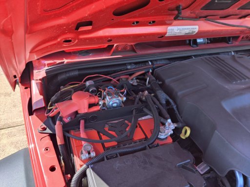

Hey, I just started to do mine. I picked up a smitybilt dual battery rack. Installed it in my 07 jk 2dr. One red top oltima Battery for primary vehicle power and a yellow top for auxiliary . I have it rigged to a power switch in cab. The aux will battery power my refrigerator, external lights,water pump for my kitchen water. Im going to add an outlet and usb ports. But so far I've only added the battery's, solenoid and the equipment relays bank. So I'd like to send pictures but I got my betty at my daughter's place. HO a wont let us work on rigs ,

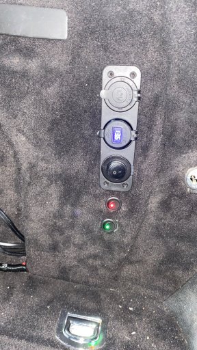

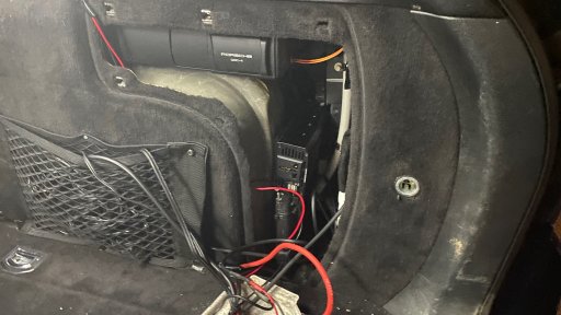

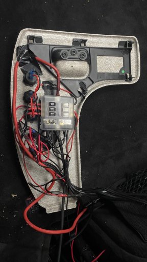

OK. So as inexperienced as I am in this subject and considering all the great comments and suggestions, this is what I went with. Two Li time 12v 100 ah batteries wired together in the back of the jeep to my accessory block that i installed in the old infinity sub box after removing the speaker. I connected these two batteries with heavy gauge wire to my starter battery with an isolator in between. Ran the positive in my frame and the negative on the top of the frame by the main wiring harness and up thru the drain hole in the jack compartment. It actually worked when i turned it all on and is charging via the alternator when the jeep is running. I'm so excited I did all this on my own with a little guidance by the local stereo shop in town. Now we're off to arkansas to test it out and see how it does!
