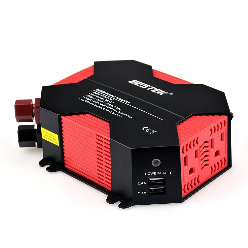

I have this Bestek 400W inverter, and with my limited testing of it using the lighter plug, it worked fine running a 150W light bulb for ~5 minutes without getting too hot. I want to run heavier wiring to the back of my Outback and using that instead of the lighter socket for more potential power if needed.
http://amzn.to/1WasyAZ

What's the size of the fuse in your cig lighter? Toyota's are typically 20 Amp which means in a perfect world, they could do 240 watts at 12V. Don't try to adapt a larger inverter with a cig lighter plug if it doesn't come with one.

Yea, my fuse is 20W, as well. That's why I'm going to hardwire it when I get home. I just ran out of time before we headed out west in mid-September. Actually, I haven't used it on the trip yet at all...
