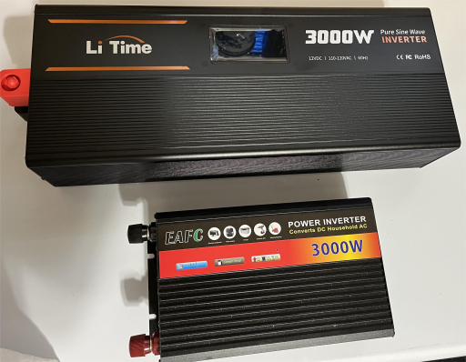

the pure sine wave inverters are bigger and beefier. i have the LiTime pure sine inverter next to a modified sine inverter i got off amazon.
HUGE difference. you can definitely tell where the cost difference is...
