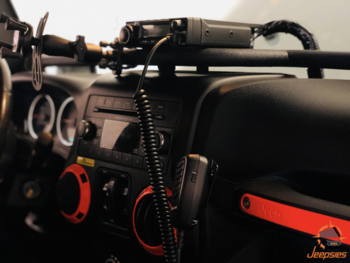

We recently installed the Midland USA MicroMobile MXT400 GMRS radio in our rig. Full transparency we are gear sponsored by Midland now though we'd been using their radios for years before they knew we existed.
MicroMobile MXT400 Install Article
This install guide should help anyone trying to install this radio, but it is Jeep specific. If anyone on another platform has questions, I'm happy to answer them as best I can.
