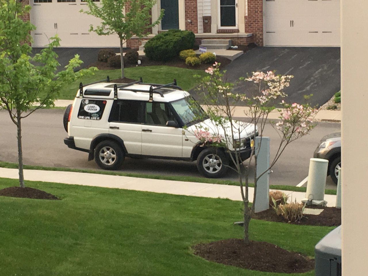

My neighbor has a beautiful Discovery 2. Parks it on the street because it leaks like a sieve and I've seen it get picked up by a flat bed more times than I can count. Good looking truck though. :wink:

Yeah Im assuming they have others work on it... does your neighbor use it for more than groceries? When I first bought mine ( and I have a good handle on mechanics ) i got scared to death when I read the repair forums and the basic grocery getter critique of horrible issues of overheating and of course cost of repairs at a dealership . the common leaks can generally be addressed.. or.. just check oil often and leak disco in the road! haha it prefers the road anyway! lol the valve cover gaskets are notorious to leak if not tightened with a 12 point 8mm socket every time you change oil as I guess there is oil that settles also above the seal line.. it can be a mess but if snugged up occasionally on the outside that usually takes care of issue... the oil pump housing gasket can leak.. oil filter not screwed on nice and tight possibly but usually thats caught early... other little things here and their but on the repair forums you can quickly deal witht hem and then just keep up the maintenance... minor things youd do on any vehicle... one thing about my experience is that generally if you do the work yourself its not that expensive... ive watched every other vehicle in the shops just as often and many of them actually stalled... the ONE thing I may have mentioned earlier is the temps.. the idiot temp gauge is VERY misleading on this aluminum engine because if it ever shows HOT, its already BEEN HOT! that is one major issue... so having a good accurate live temp gauge, oil pressure gauge, and i use live OBDII gauge to monitor the ECU actual temps... ive basically driven it around with no real maintenance besides required maintenance... the vehicle is very capable and reliable but those few things have to be upgraded and followed... every vehicle has its quarks and land rovers is... keep up maintenance! lol BTW my neighbors Toyota Tacoma has most the same issues because its not maintained as well as it should be and from his perspective my land rover is more reliable lol

Haha, I don't know. They have a fancy sticker in the window and yellow driving lights, so they must use it for something, right?
Seriously though, I love the Disco I & II. Sexiest SUVs ever made.
