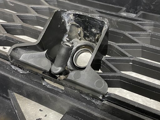

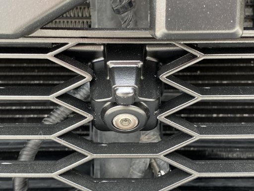

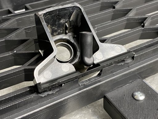

Somehow I neglected to take a photo of the front of the truck right after I installed the ADD Front Bumper. I did not like the way the stock grill looked with the bumper, so I ordered one of the Raptor Style grills off ebay and modified it to house the front facing camera from the stock grill....
Had to remove just the center portion and using a dremmel tool, took my time and a little at a time created a seat for the stock mount. I did have to cut off part of the stock mount as well. I then used Plastic Weld to attach it and sanded everything flush.

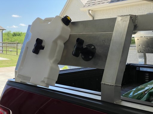

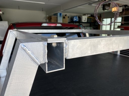

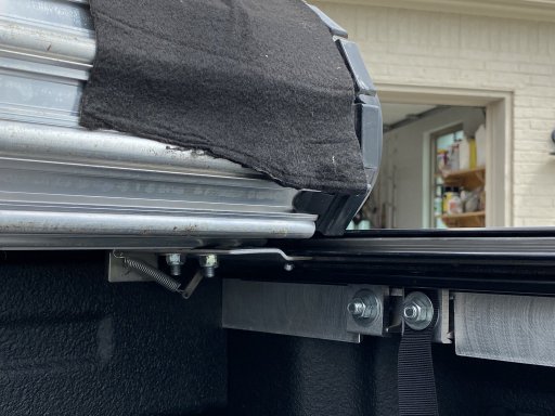

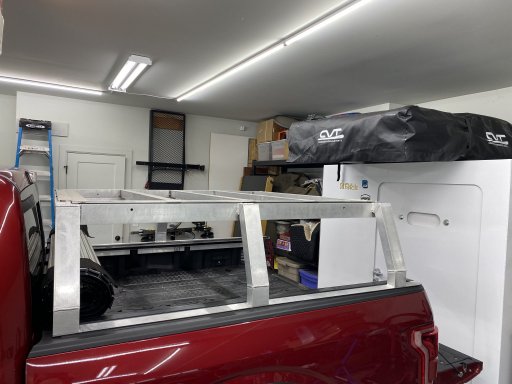

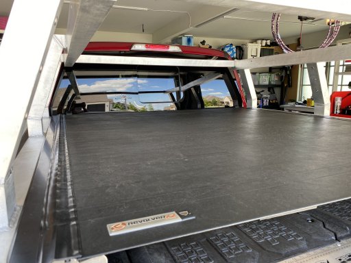

So I already sold the CVT Mt. Ranier and I have the custom rack and bed cover up locally for sale if anyone in the area is interested. Since my last update I've put removable mount plates on both sides and added rivnuts for Rotopax mounts to perfectly tuck two 2 Gallon containers on each side. I also have the bed liner material to finish it. I was in the process of making some scene light mounts when I changed course. Asking $1300 for rack and bed cover (bed cover cost $900 new). Here are some additional photos from what I already posted.

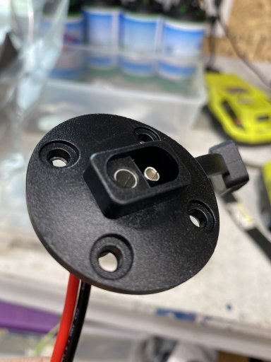

The Bluetti fits perfectly under the rear seats so I am going to fashion a strap to strap it in place and plug it into a key switched 300w pure sine wave inverter (I don't trust the factory inverter). I am in the process right now of running an Anderson connecter from the under seat storage panel to the left tailgate "ammo can" of the Decked box.
I've put an additional marine switch, voltage meter, two 12v sockets and two usb sockets there using the "ammo can" as a junction box.
So, all I'll have to do is strap the bluetti down, plug it into the Anderson connector, and plug the charge port into the inverter and I'm ready to roll with on the go charging and be able to power devices from the bed of the truck. The fridge will be plugged in back there all the time of course. Anyhow, if anyone is considering battery power and solar, I can highly recommend the Bluetti.
Peccavi18
536
Pittsburgh, PA, USA
Ryan
Rogus
Your rack was awesome, exactly what I am looking into doing except want to use the stake pockets for attachment. The height was good and the back bar being removable was clutch for fitting in larger loads. Mind sharing tube size and wall thickness? Also was it 6061 or 6063? I'm not a tig welder but I think I can get someone with skills to do it. Especially if I get the cuts ready and help prep stuff.
