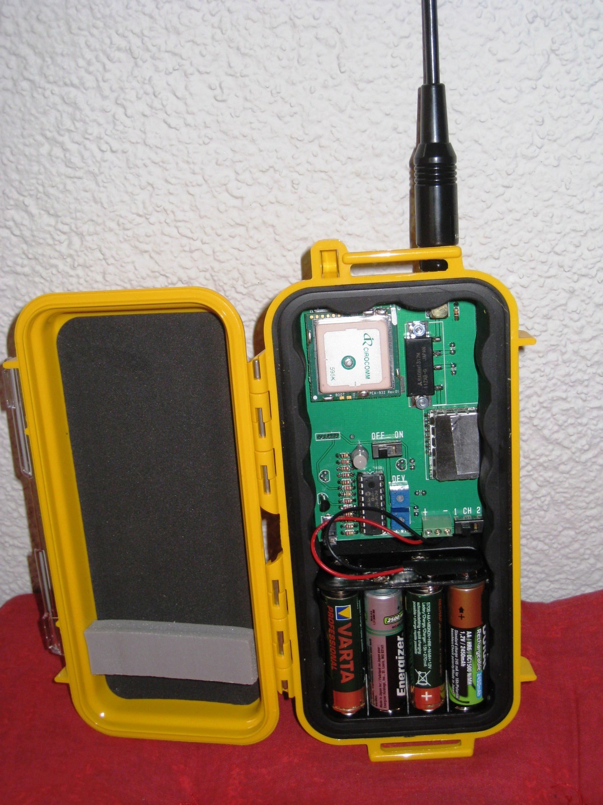

So exactly what is APRS and how does it work?
In short APRS allows your location (Lat/Lon) to be transmitted by your radio to be received by others. Others could be in your convoy or (possibly) on the internet given the right circumstances. The APRS “system” include repeaters (digipeaters) and internet gateways (igates) though you cannot rely upon hitting any of these with low power RF being what it is. All of this assumes that your radio knows where it is and this is typically achieved with an internal or external GPS connected to the radio. APRS also has the ability to transmit short text-only messages and if you can hit an iGate and know the proper magic incantation those can be forwarded via SMS or email. That is a very short overview of a pretty neat system.
Edit - if your position packets make it to an iGate they will end up in the "APRS-IS" and be available internet users to see. When I go on long trips without the family I always provide them with a link that shows my latest position - latest if I can get iGated which does not happen a lot in the wilder places.
