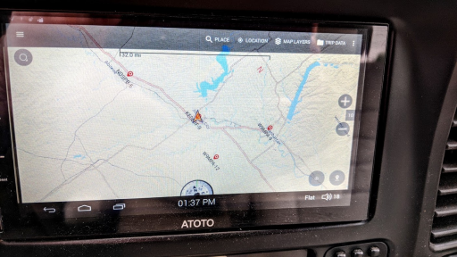

APRSDroid will overlay received APRS information in Backcounty Navigator Pro and XE.
I have been rocking one of the original Mobilinkd Bluetooth TNC's for several years. It still works beautifully! I started using it with a Baofeng radio then moved it to my Kenwood TM-71A. The only time I have EVER had a problem with it was when my data cable came unplugged.
Very nice, with Backcountry Navigator Pro (seems to have a couple of options) are you subscribing to one of their premium map services or just using the included maps that come with the purchase of the pro app?
Are you using Voice Alert at all? So I believe a temporary workaround for me on the Voice Alert issue is setting my HT to monitor the APRS channel for the CTCSS RX only and just having it in the cab with me so that when the packet is RXed with the tone I am alerted to then make a call to get a QSO on simplex.
I have not subscribed to any of the PRO maps, but I am a subscriber for XE and XE maps.
