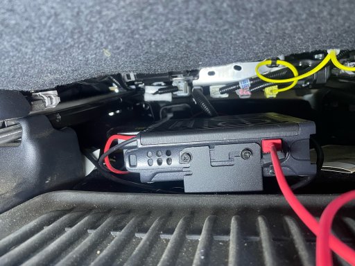

I got the KG1000G Plus "for Christmas". I have to say that I'm really happy with it so far.
I'm clearly hitting repeaters 40 miles away. It's pared with the Midland MXTA26 and it's mounted on the hood in a terribly sub optimal place. So far I've defaulted to medium power for most comms and it's run well.
This is all of course limited time installed. The most comparable radio I've had with it in the past was the Midland mxt400 with a browning antenna.
My biggest gripe is the software to program it. I haven't take the time to look at the saved file format yet to see if I can program it that way.
Before anyone asks, the battery is also for the VHF/UHF dual band that I haven't installed yet.
