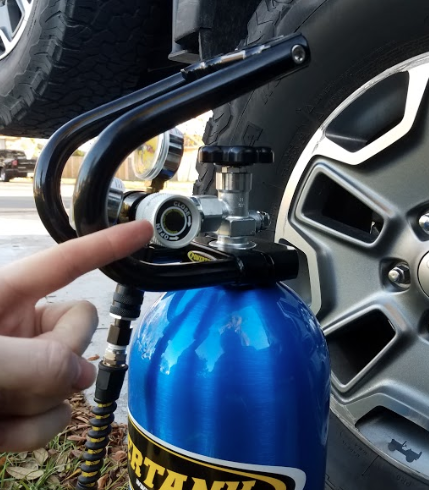

Step #2: Assure your regulator and main tank valves are seated in the CLOSED position before starting. Assure your high pressure hose is securely connected before opening any valves.

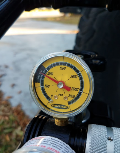

Step #3: Visually inspect your primary tanks PSI meter to ensure you have the proper amount of pressure within the tank.
Step #4: When you are ready to opperate the system FIRST open the primary tank valve by turning the valve a few times counter clockwise. This will allow pressure from the tank to flow out and rest against the inside of the regulator. No Co2 will be flowing to your hose at this point.

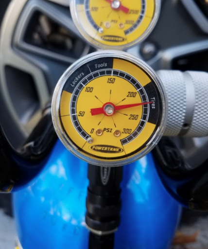

Step #5: Now that your primary tank valve is allowing Co2 to flow to your regulator, slowly open the pressure regulator valve and watch the needle on the regulator meter rise as your hose becomes firm with pressure. Watch the regulator meter to find where the appropriate pressure should sit for your task.

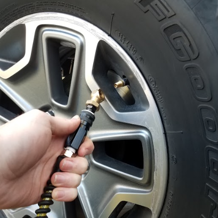

Step #6: When filling your tires with Co2, take the air chuck and press firmly to the stem to allow air to flow into the tire. Check your tire pressures periodically since the Power Tank does allow for a high flow of Co2 when entering the tire.

Step #8: SECONDLY close off the tanks regulator valve. When sealing this valve you will head an audible purging of pressurized air escaping the regulator. This is completely normal as there is still pressurized Co2 within the regulator and hose. You will notice the needle on the regulator dropping as you continue to close off the regulator valve. Once closed off and the system has been purged you should notice the regulators needle resting at zero on the meter.

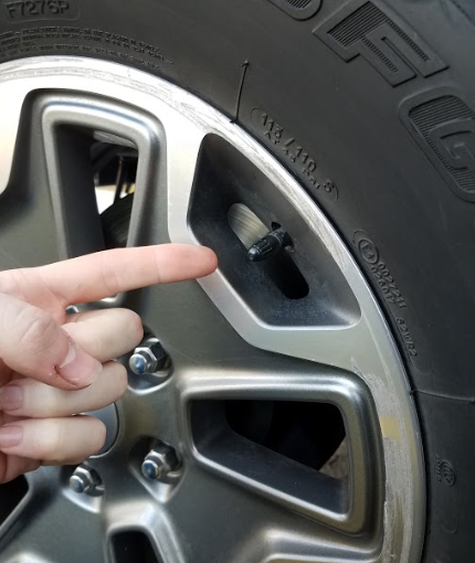

Step #10: Always remember to replace stem caps! These are a B word to loose.
